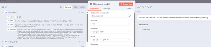

It worked yesterday, but today suddenly this error came out.
As you can see, the Input is clear and I’ve searched “role” column all over the nods but there are no such things.
In the image, it appears on Message a model nod,
but time to time it happens Google Sheet nod or Send a mail node, too.
Problem in node ‘Message a model‘
column 9827483463398fbb7d6b96916fe451d8bdefa0e8.role does not exist

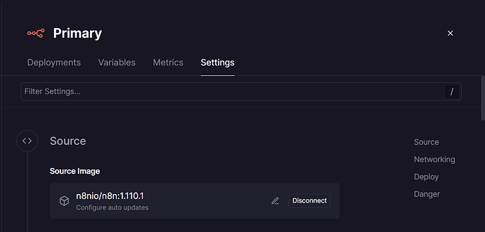

This solved my issue. Even though I had automatic updates turned on, neither one was updated to the latest version. Update both to the latest version. This version and restart redeploy.

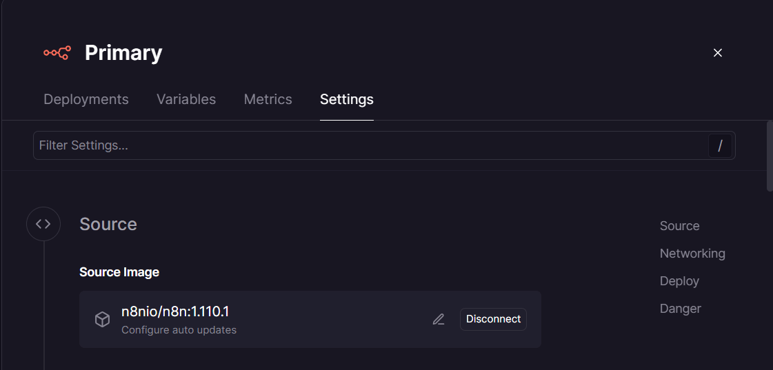

This solved my issue. My Primary was the only service I was redeploying to update n8n, but I also needed to redeploy my worker. Keep in mind guys, if you have n8nio/n8n as the source image, it is already pulling the latest version so you just have to redeploy without editing the source image to n8nio/n8n:1.110.1
you statement is incorrect on my issue. I was updating 1M times, redeploying. didn’t work until I actually named the current version. Do I need to change it back so the future updates doen’t break it?

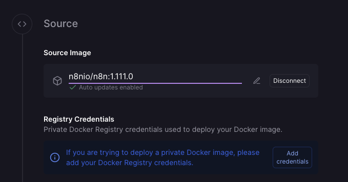

Redeploying (at least in Railway) n8nio/n8n keeps bringing the .110 version.
For anyone else using n8nio/n8n (which is the popular n8n with workers template in Railway) you need to manually type the docker image for the .111 version. Redeploy and you will fix this problem.

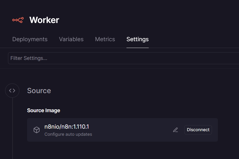

NOTE: you will also need to to this in workers instance to solve the column problem
I managed to solve it.
I use Self-Hosted. In my case, I had updated the editor but not the workers or the webhook.
In short, I kept them all on the same version: latest, and I’m no longer experiencing the issue.

Funcionou dando redeploy no worker (self hosted)!!!
Ah man. You have no idea how happy i am that i came across this comment. I have been trying to figure workarounds since a week. I updated Postgres, redis, worker & primary and everything is working smoothly.
Question though, how often do you end up redeploying all 4. Till now i was only redeployng my promary instance and that eventually lead to all the issues. Do you update all 4 everytime there’s an update?
