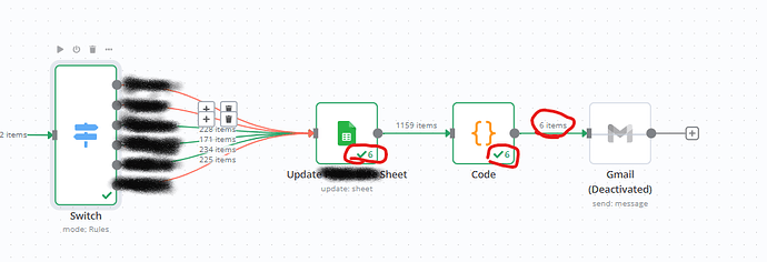

Hello all, I have a flow updating data into different google tabs. I used a switch block to divide data into different groups based on Tab name, and then insert them into different tab on Google Sheet individually. I do this step because it can only insert one Tab in Google Sheet step without switch block.
However, when running the flow, it always run six times causing the final email notification step running six times, which I only want to run once. If there any ways to force the final emails step only running once?

Thanks for your advice, I tried both ways but doesn’t work, maybe I need to modify something about Google Sheet Node so that it can match different tabs in one run…
I tried “Execut Once” but it only works on the first item of each run, and my flow seems run six times, so it would still output six times.
The aggregation node also run six times if added after switch node.
You can append the data with the merge node to bring it all back into one item list
I add it after switch node, in that case, “execute once” does work for only running on the first item, but google sheet is only updating one tab, it seems that in each run & update, google sheet can only choose one tab.

Purpose of Switch node:

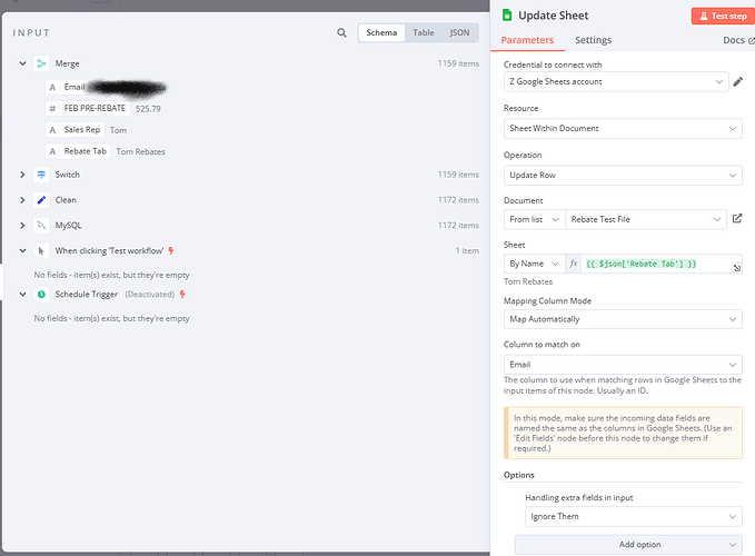

Google Sheet node can only choose one tab to update each time.
Though my data source has a category column deciding which tab the data should be inserted, the Google Sheet node would still choose the first item’s category as the target tab, and then update all data into this tab.
After applying Switch Node, the data is divided into six batches based on category(Tab), each time Google Sheet node choose one batch to update and update them all into the same tab.
If I don’t apply switch, that means all data will be run in one batch, and all 1k data should be inserted into one tab regardless which category it belongs.
So I think my real questions is how to merge different batches into one batch, and let it run only one time in the following steps.

Chances are that with Minimise API Calls option on Google Sheet node it sends data in batches.
Then grouping data per sheet would make sense.
