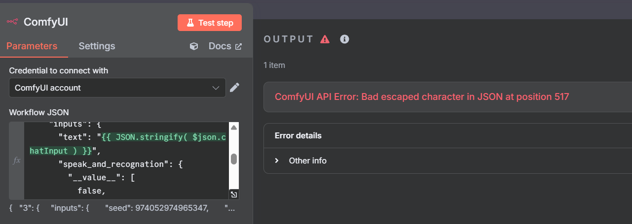

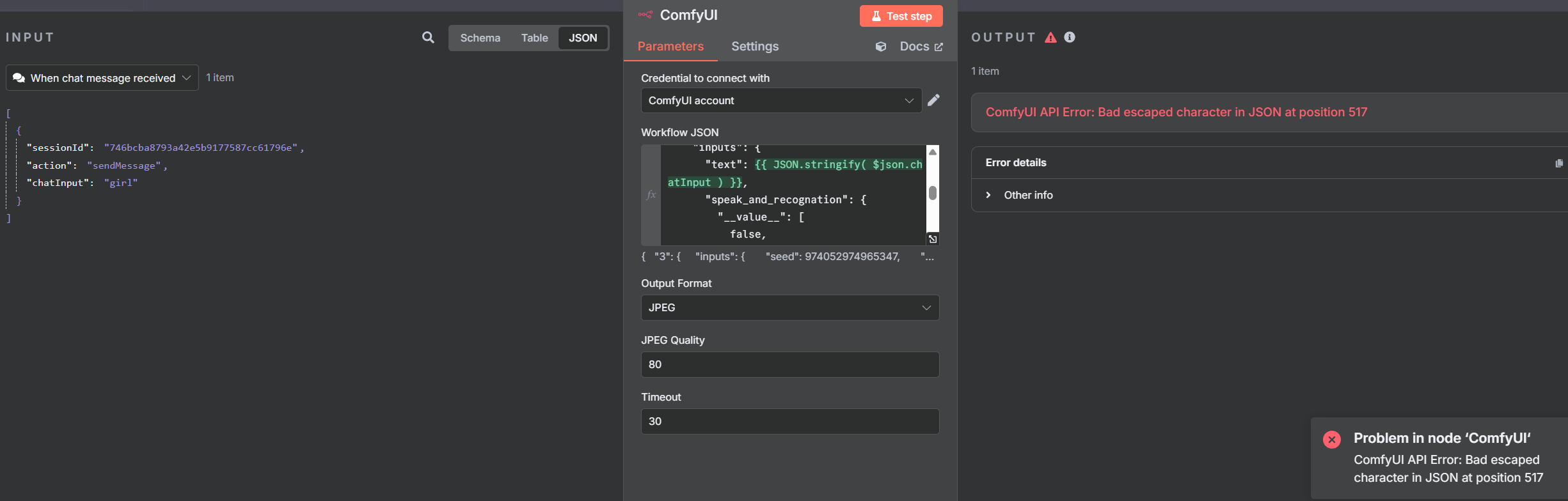

I’m following some community tutorials that suggest replacing a static prompt with {{ $json.chatInput }} so I can dynamically inject prompts from earlier nodes. However, when I try this, I get the following error:
ComfyUI API Error: Bad escaped character in JSON at position 517

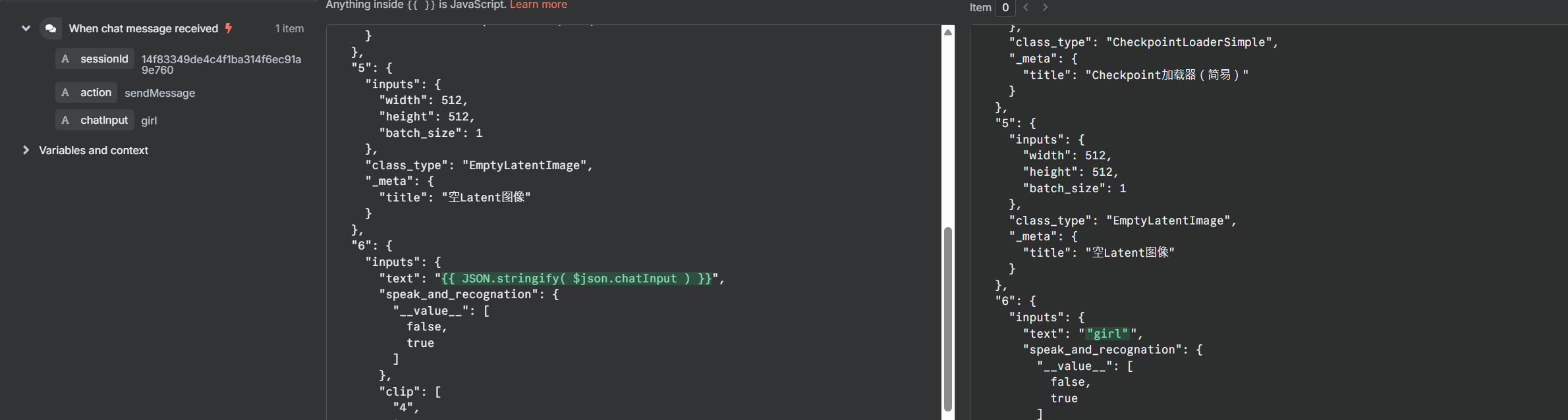

Could you please try to use JSON.stringify() like this:
"text": {{ JSON.stringify( $json.chatInput ) }}
Hello, thank you for your reply. :pray:
I tried your suggestion of using {{ JSON.stringify($json.chatInput) }},
but unfortunately, I’m still getting the same error.

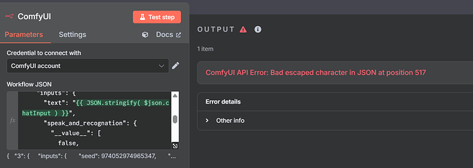

Hi @BearDD
Please use it without quotes, as JSON.stringify() automatically adds the quotation marks " "
just like this:
Thank you again for your reply. :pray:
I gave it a try, but unfortunately the error is still the same.
I also rewatched the tutorial video I mentioned earlier.
It seems that the original setup in the video still includes the quotation marks (" "),
but it works fine and successfully generates the image. :tired_face:

I added a Set node before the ComfyUI node, pasted the JSON that ComfyUI uses into it, made the necessary changes to chat_input inside the Set node, and then passed the entire JSON to the ComfyUI node.
And… it worked!! :tada:
