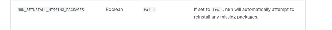

@ianpogi5 I think what you are looking for is this Deployment environment variables | n8n Docs
