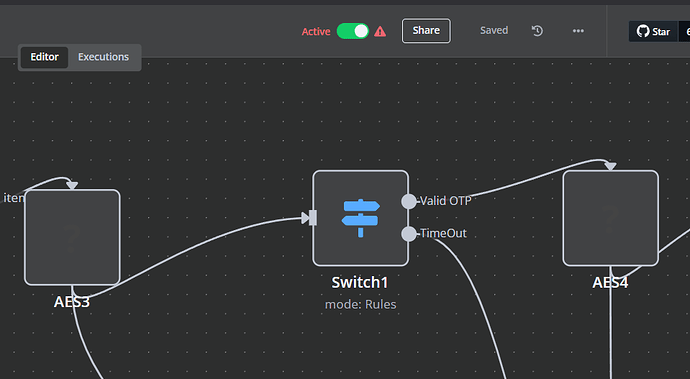

I like to keep my n8n version updated for all the new feature. I dont have much there just under 50 workflows. However, my community nodes get deleted after every update. I have self hosted at railway.app. I think it happens due to not attaching a volume at me primary instance? If yes, then can anyone tell me at what path should I mount it. Should i mount it at both Primary and Worker?
Here is the workflow picture:
Here are my community nodes (only one here, AES node got deleted):
