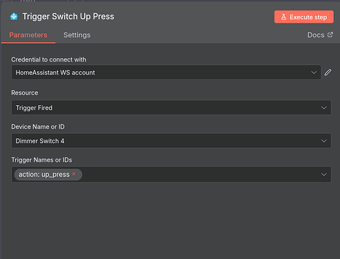

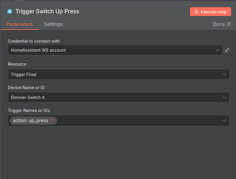

These add lots of functionality, most notably a fast trigger node:

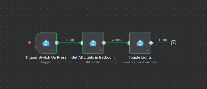

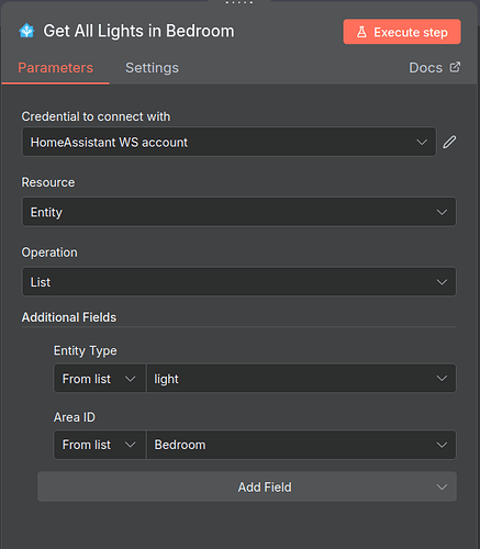

This example triggers when a button is pressed, retrieves all lights in an area and toggles them.

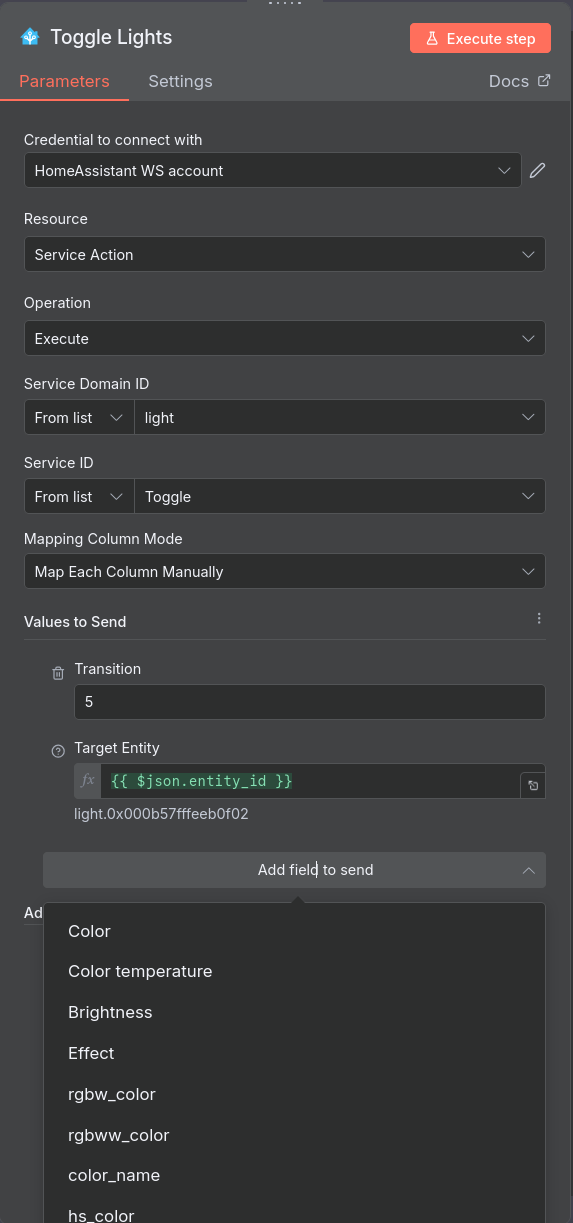

The fields are automatically populated from the Home Assistant instance, and easily accessed and searchable. It even retrieves the required and optional fields from the service actions, ready to be filled.

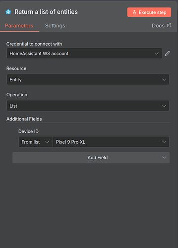

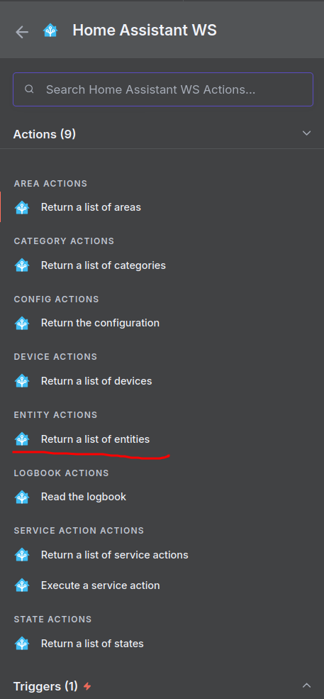

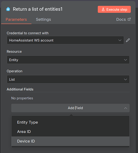

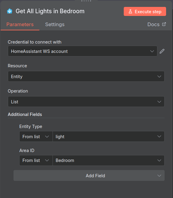

Using this, how can I get all the entinty states of a specific device? Lets say I have a device that is named “Electric Water Heater” , how could I make a workflow that gets all the entities of this device?
There are a few options in the Additional Fields part, where you can filter entities by device id:
