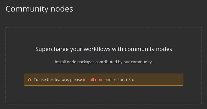

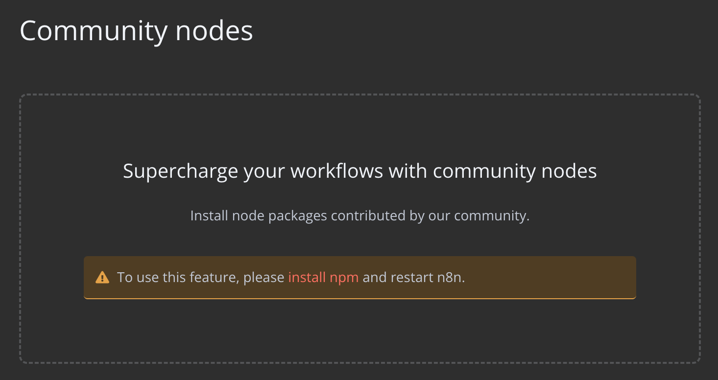

I’m trying to install (or at least vies) Community nodes
on my local n8n , with PLESK installed selfhosted node.js (npm also installed)
Unfortunately something seems to prevent that n8n can use npm
Supercharge your workflows with community nodes
Install node packages contributed by our community.
To use this feature, please install npm and restart n8n.

Hey @OzDreamWalk,
Welcome to the community :raised_hands:
It looks like the command we use to check if npm is installed is failing on your installation so you will need to make sure that npm is available to the user that n8n is running as.
I would however recommend using Docker instead of going down the route you are trying as I suspect you will run into other issues in the future as well.
