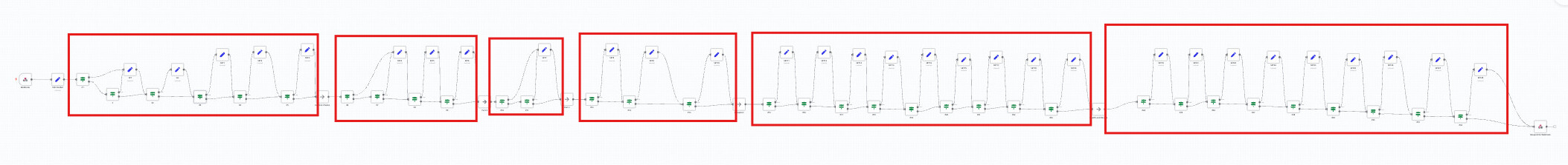

I wanted to share one specific use case we’re struggling with right now.
We’ve created a workflow (screenshot attached) that only contains a series of IF and SET nodes. These nodes basically decide on a response based on the input coming from a Webhook. It’s just a small part of a larger workflow we’re building.
We know this structure is not the most efficient, but we intentionally avoided using the Code node because our non-technical teammates are maintaining these workflows and it’s much easier for them to follow the logic using visual blocks like IF and SET.
Previously on version 0.198, we were using FunctionItem nodes and everything ran smoothly. After upgrading, I tried replacing those with Code nodes — but then encountered execution issues (errors during runs). Based on the memory-related documentation, I switched to using Set nodes instead to reduce pressure — but the issue remains.

Well… that looks very unpractical :sweat_smile:
Can you share the first 5-10 nodes alongside with the sample input (you can remove any sensitive content from it)?
You can select all nodes you need and copy them with ctrl+c. Then past the content here after pressing button </> with ctrl+v. I may show additional context about the possible issue
Still, it doesn’t seem to be too big for the n8n to process. However, it may depend on the input data and the set mode (return all input + new variables vs return only some fields).
I also see some patterns on the canvas, which may be easier to offload into a separate sub-workflow. In that case your non-tech guys may implement additional IF logic later and attach it as only one node to the main “chain”

I see two issues here:
  1. You are turning on the option to include all data for all nodes, however, you don’t need the whole input for them, the nodes can look only for one part of the input data within the first node
  2. you are adding the tag via Array.concat() method, which copies the existing array (5 nodes – 5 more arrays)
Both issues may lead to the significant performance issues with increasing the number of nodes (it behaves as a snowball, which gets bigger each time you add a node)
One solution: migrate to Switch nodes instead of the chain of IFs
Pros:
It won’t duplicate the input data and won’t add any new arrays during the run
Cons:
it still ‘heavy’ and hard to expand
Second Solution (preferable) will consist of multiple workflows.
Master or parent WF
Sub1 WF:
Sub2 WF:
Sub3 WF:
Pros:
It’s easier to read, manage and add new conditions
Cons:
It requires a little more effort to implement
