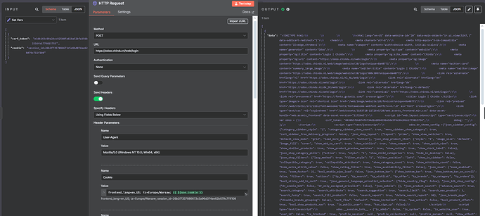

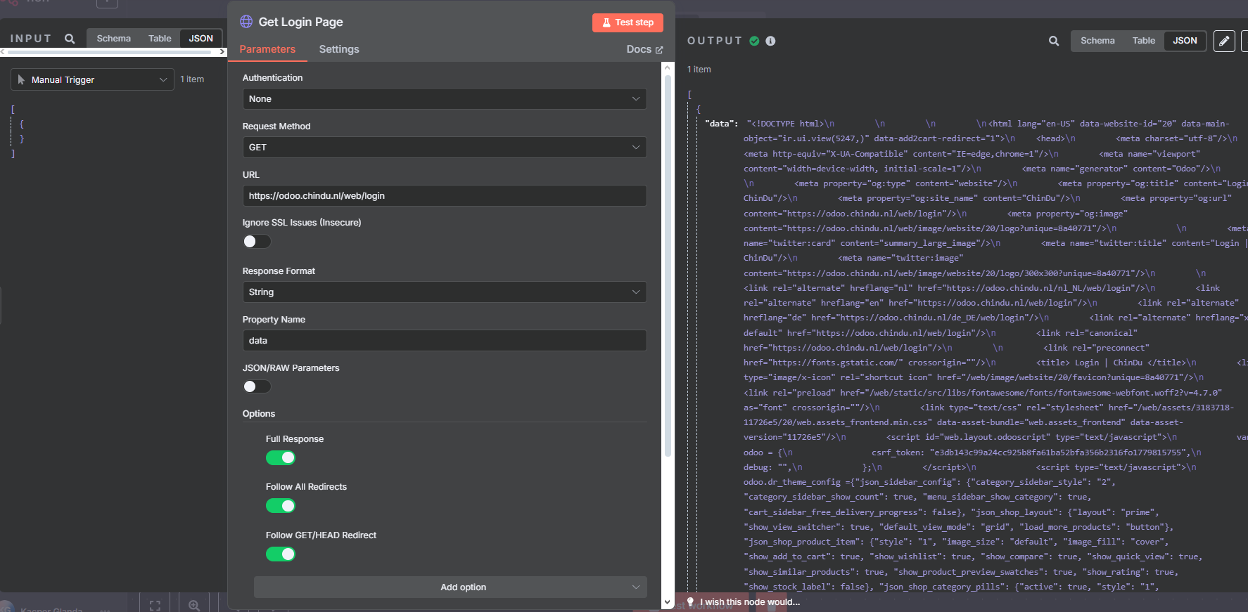

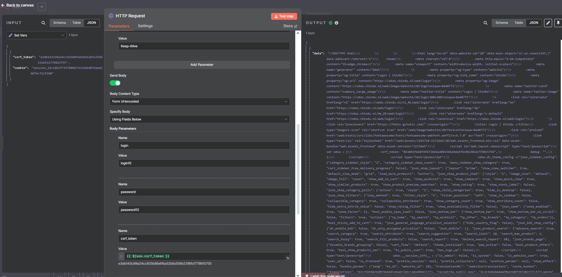

I’m trying to connect to Odoo using n8n, specifically via HTTP Request login/password, but something is not working, I would like to ask for help with this, I get the session id and csrf token using GET, but with POST it looks like it is not logging in correctly because it neither returns cookies nor redirects, even though I have set the redirect x times already, I am also sending the workflow(couldnt send it so showing GET and POST settings , maybe you will see where the error is or something similar
Output from http request post is kinda long so i dont wanna post it
body is just html login site

Well, I would need n8n to log in as a user (user-agent) and theoretically everything looks good for it to work, but it doesn’t work, if anyone has a solution or something similar to do this, or even tools or a way to check why it doesn’t go through as it should, I would be very grateful.

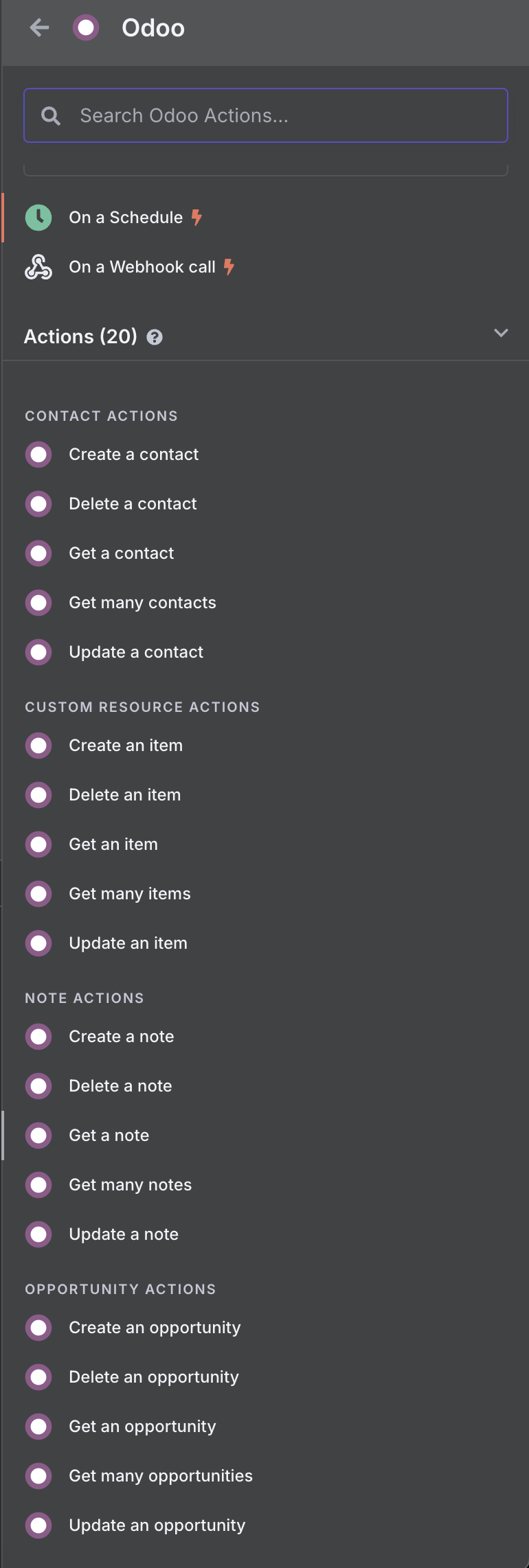

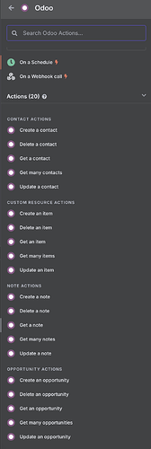

Do you know there is already a odoo node that can perform following actions ?
Just curiout what kind of action you want to achieve here that API can not help you.
Like @King_Samuel_David said : performing browser automation is not an easy way.
It is if ure the owner of database that is hosted on odoo not if ure an user, if ure user this is useless cause u dont have info about db
The current Odoo node there is no way to call methods (e.g. confirm order).
