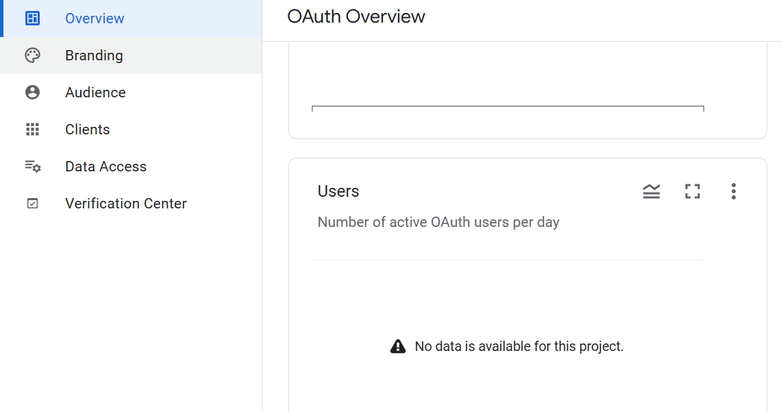

Not sure I follow. You mentioned you couldn’t create a user, but you’re just adding existing users to the list, not creating anything. Maybe it’s just a terminology thing, but something doesn’t seem right. Is the Google Developer’s Console page not permitting you to click the Add users button and type in an email address? Is the button disabled? Could you post a screenshot?
So… that’s the “Overview” page. What do you see if you click “Audience”?

What took you there? Did you attempt to publish the app? Are you talking about the verification process for restricted scopes? If so, you don’t need to do all that. You can use the app from n8n with one or more test users, just by adding them to the list on the Audience page.
It looks like this. The place to add Test users is at the bottom of that page.
