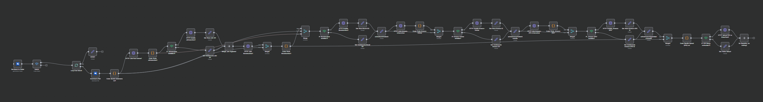

Connecting nodes correctly. I have created my first real workflow. It is very complicated. I noticed that with every HTTP request query, the previous node, which is before the HTTP request, for example the code node, is not transferred with the data via HTTP request. That is why I have added merge everywhere. Am I doing something wrong here, or do you know of a better solution?

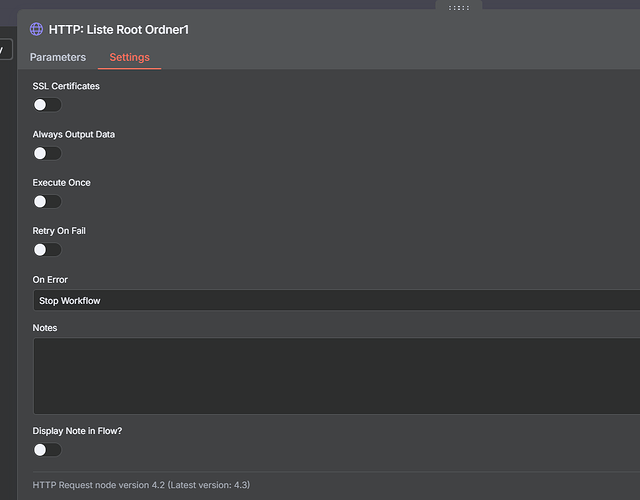

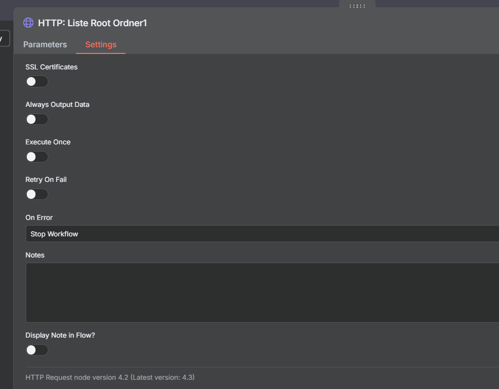

Hello, could you tell me exactly which option I need to activate for this? Thank you very much for your help!
or here?
For items within a loop, you need to get items from the loop node instead of taking it from the switch node or the first node. This way, for each loop cycle, it will change the data accordingly. From what I can see in the provided image, the data should reach the loop node without being affected so inside the loop, you can refer to that data items via the loop node items just as I showed you in the example in my previous comment.
In your case, If you include the workflow instead of the image, I can pinpoint exactly how to effectively reference data in each node instead of using the merge nodes.
For example: you are merging the data of https request node with the output of the first code node and then sending it to the next code node but you don’t need to do that, because you can just reference the variable in the second code node with this format:
