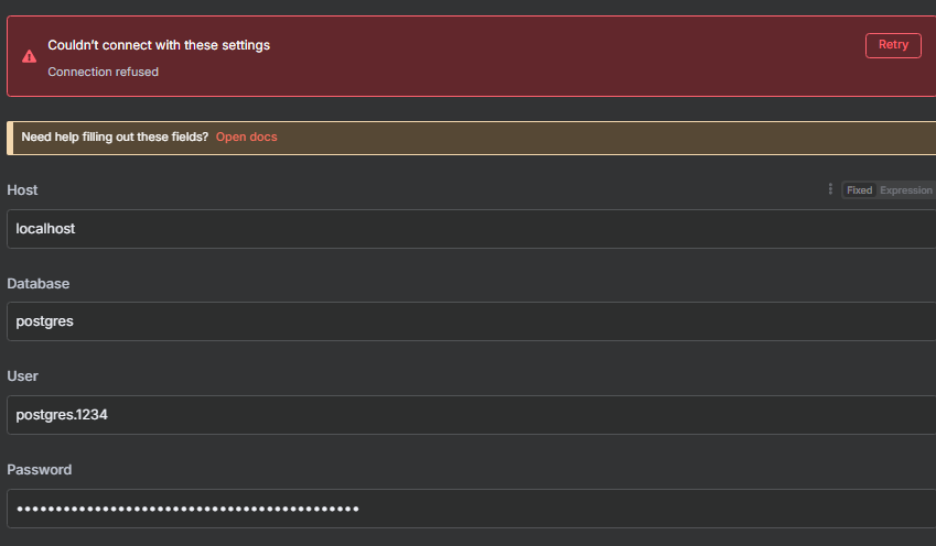

Hello, I’m trying to create a postgress credential on N8N to access the supabase without success. The test information is below. How would I configure the node please?
POSTGRES_PASSWORD=your-super-secret-and-long-postgres-password
POSTGRES_HOST=db
POSTGRES_DB=postgres
POSTGRES_PORT=5432
default user is postgres
POOLER_PROXY_PORT_TRANSACTION=6543
POOLER_DEFAULT_POOL_SIZE=20
POOLER_MAX_CLIENT_CONN=100
POOLER_TENANT_ID=1357
