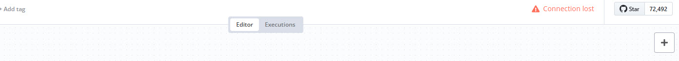

Over the last 2 days, I have been receiving “Connection Lost” messages a few times a day. Is this normal? Is it a system issue?
Connection loss on what? From you to n8n? Or from n8n to another service? Other service could be “normal” if its under high load.
I have no idea, it just says “Connection Lost”
I thought it meant connection to n8n, which is what I suspect is the case because all I did was refresh the screen, I didn’t try to run the workflow.

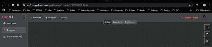

I am using the cloud hosted version of n8n, not self hosted. and it is still down even as of a few minutes ago.
Ah, I see where I misunderstood. I assumed hosted meant self hosted. Usually we use cloud vs hosted as nomenclature.
Do you use any adblock or local caching extensions? Does the same occur in incognito mode, and other browsers? What about on a VPN? Same thing?
No worries, I tried an incognito window and it worked. So I decided to reboot my machine and now it works. So now I may need to reboot when this happens again. Thanks for your help!
