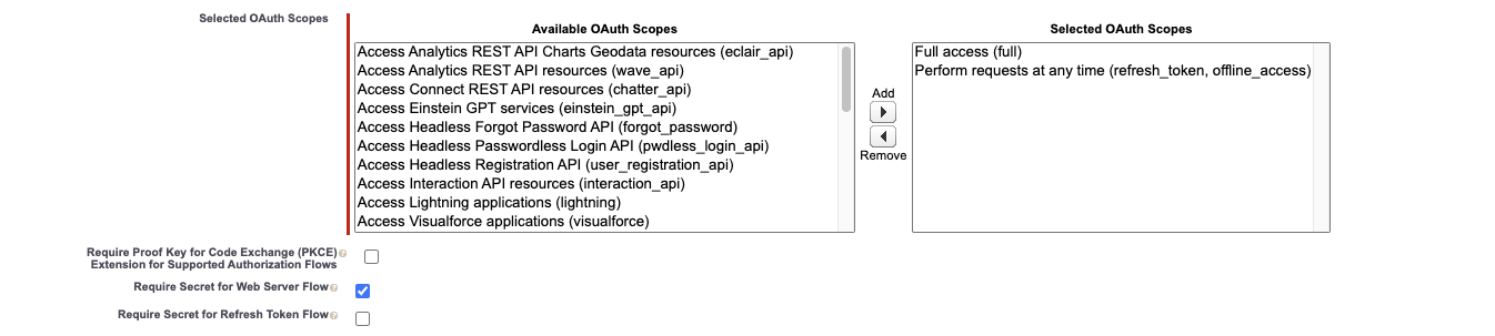

Is the app you are connecting to in Salesforce new or old and does it have PKCE enabled?
Sure, thank you Jon!
No, PKCE is disabled. We attempted connections with both the new and old Salesforce apps, but unfortunately, no success.

Have you tried making a new app in Salesforce to see if that helps?
