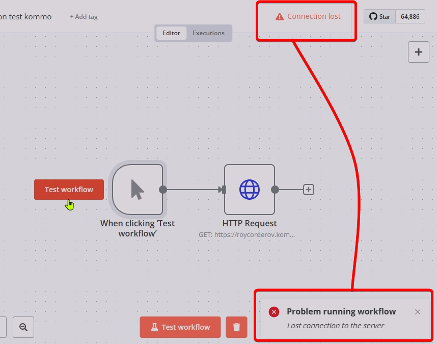

Connectivity problems with n8n
I’m having some troubles in my n8n with the saving and test step. cuando estoy empezando a crear el flujo y coloco el api de mi plataforma a conectar (kommo crm) yo presiono sobre el “test step” y sale un error abajo que dice “lost connection to the server” and the workflow also appears “Connection lost.”

  • n8n version: 1.80.5
maibe its important to clarify that I have N8N installed on my local server, and go to the Internet through Cloudflare Zero Trust Tunnel
Hi, I have the same problem on my cloud server on hetzner:
  • n8n version: 1.81.4
  • Database (default: SQLite): Sqlite
  • Operating system: Linux
I solved it: in nginx conf I added:
# Abilita WebSocket
proxy_set_header Upgrade $http_upgrade;
proxy_set_header Connection “Upgrade”;
proxy_http_version 1.1;
so, the problem would be in the Nginx Ok … thanks I will do it and notify if there was any change
thanks the problem was the nginx and its solved
Great that it solved your issue. Can you please mark the reply with the solution as the solution as well. :slightly_smiling_face:
