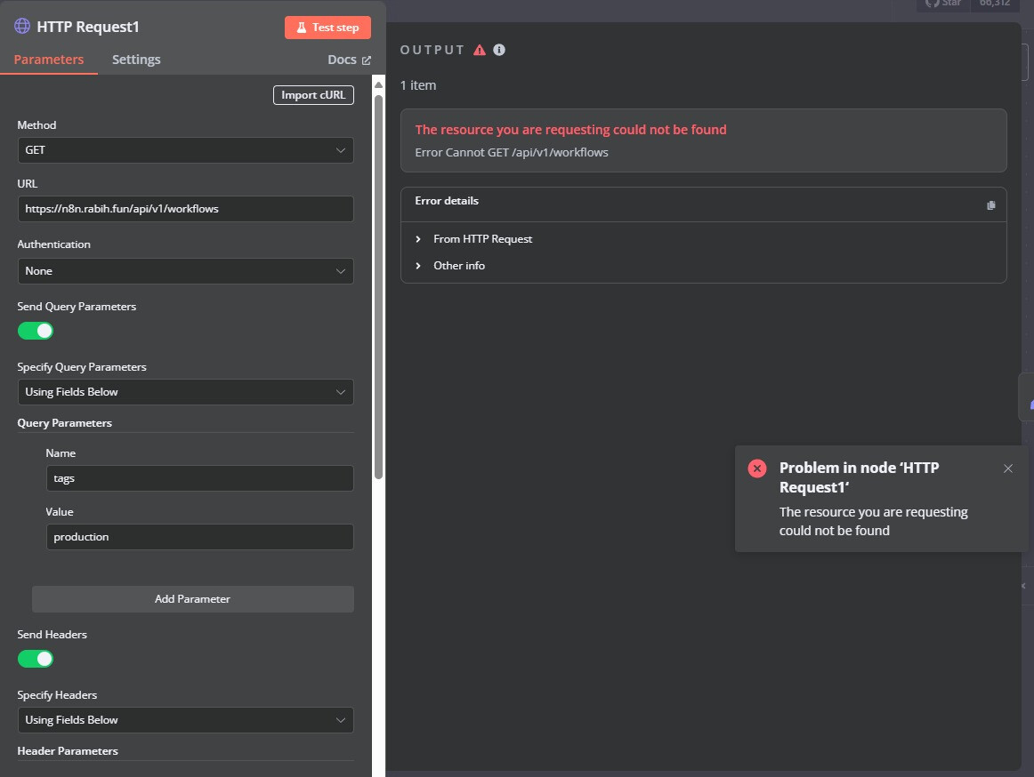

I switched workflows, but now I’m getting a 404 while getting workflows:
HTTP 404 There was an error: “The resource you are requesting could not be found”
PS: I’m selfhosting on the cloud. What should my n8n API base url be in the credential?

yeah something definitely changed.
it’s not working anymore.
This was my 2 march execution
and now it give me this:
i literally copied the same workflow from this execution.
Even created 2 new APIs
What happened, did they change the get calls?
could you expand the “From HTTP Request” and “Other Info” in the http node?
It’s still working for me.

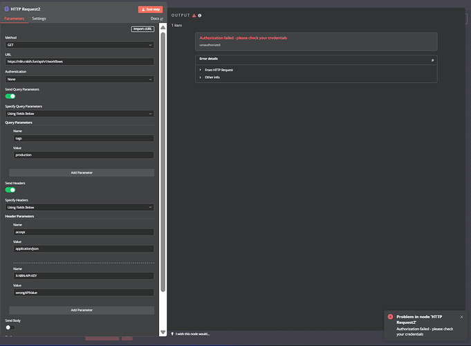

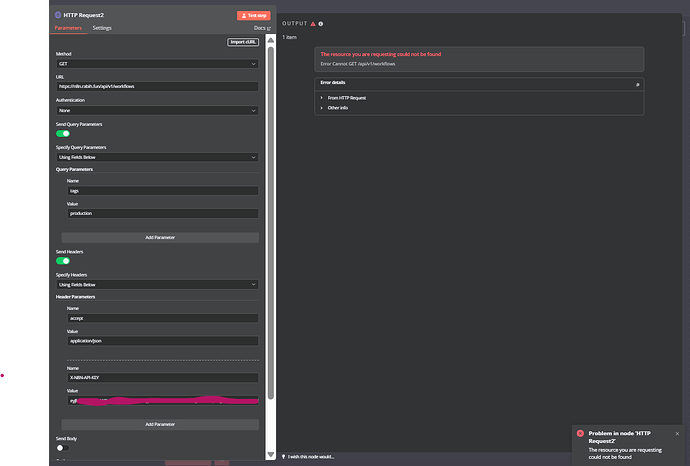

second photo is a test with a wrong API.
Results of both tests (photo1 and photo2) in n8n logs:
404 - “\n<html lang="en">\n\n<meta charset="utf-8">\nError\n\n\n
Cannot GET /api/v1/workflows
\n\n\n”
401 - “{"message":"unauthorized"}”
I really can’t see why it would not work.
Here’s my workflow, just tried it and still works.
I just restarted my n8n/caddy stack, and now it’s working.
I don’t know what was wrong, no settings changed.
