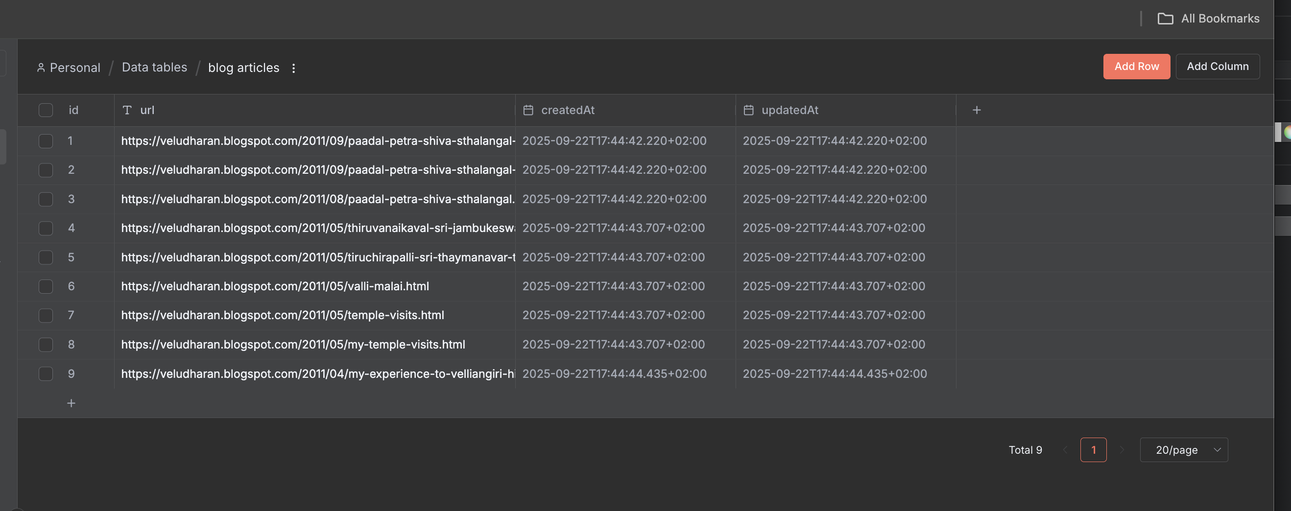

This is a good usecase for new data tables feature.
Simply split the workflow into two steps.
  1. write all the urls into a single database
  2. read all the urls and query them then convert
Here’s your workflow split into two such phases
This is what it looks like in the Data Tables page
