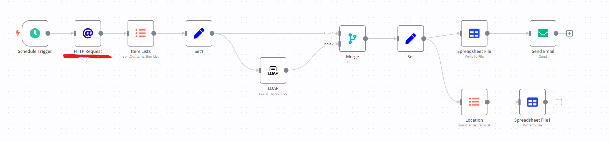

I am using just the spreadsheet below is the complete screenshot related to it.
Currently, I am send the complete list of data into an email using spreadsheet. Now I want to send send separate spreadsheet with the above data related to project and location count as mentioned below

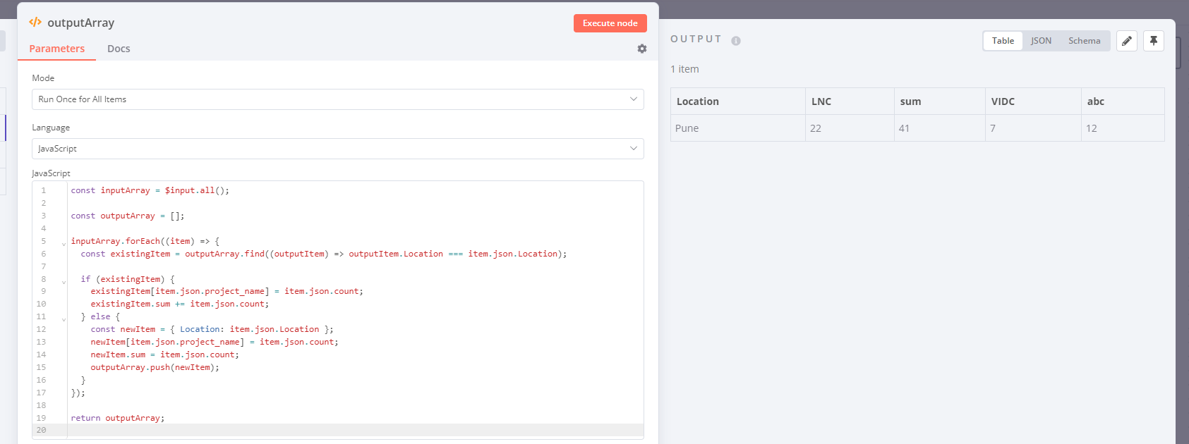

Hey sorry to high jack this thread.
Try this also, i think it works

Try this now
