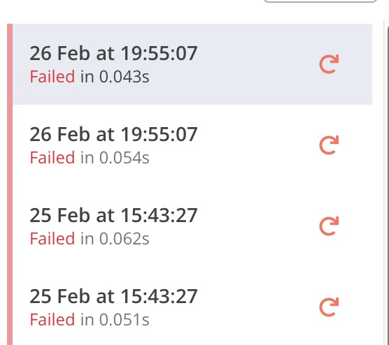

Snímek obrazovky 2024-02-27 v 14.07.39
As you can see, the Stripe trigger gets activated twice at the same time. When a user makes a transaction in Stripe, Stripe sends two+ calls to the webhook at the same time (sometimes a few milliseconds apart).
Stripe recommends that you use some kind of persistent storage to check if the ID of two events are the same, and discard the extra triggers in case the IDs match. This is what I’m trying to do, but I don’t want to create an entire database just for this one thing, so I’m using a file instead. And this is where I ran into the problem I described in the OP.
If I don’t do any debouncing, the workflow triggered by the webhook call from Stripe would send up to four emails to the user at the same time, which would be pretty annoying for them.
@buresdv , are the payloads for the two calls identical too? Perhaps they correspond to different events taking place in Stripe you subscribed for? Multiple webhooks calls could be normal but if they are totally identical (the very same payload) then it doesn’t sound right. You might need to check with Stripe support.
It is quite common for the webhook to resend the payload if it did not receive the expected response from the endpoint (say, after 30 secs). However, in your case, it does not look like a repeated call as they come simultaneously.
You were right about there being something wrong with Stripe. The duplicated calls were a result of a problem on their side that they had to resolve via a support ticket, so that part of the problem is resolved now :slight_smile:
