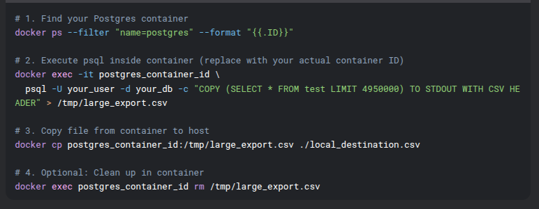

Yes, also thought about doing it via Shell-Node and with having psql used in there but won’t work like described from deepseek AI as it is an external postgres server where I am not having directly access to.
So, ended up with the following which is working quite good & fast:
a) SSH into an instance with psql installed and executing the command from there and also gzip’ing it
b) Get file over SSH
