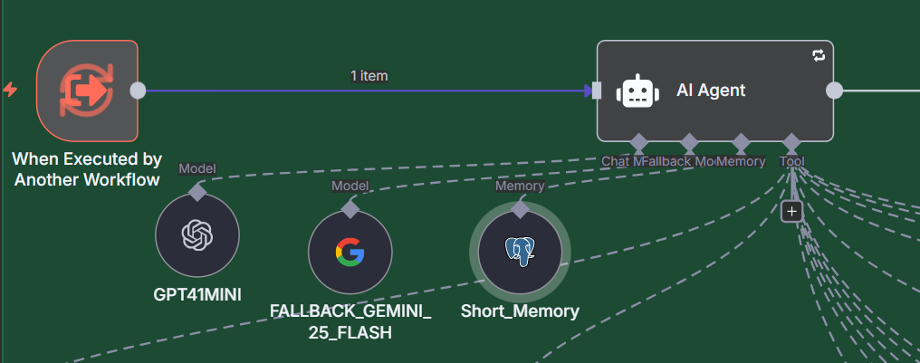

I’m using the Postgres Chat Memory integration with the AI Agent node, and I want to update the stored messages so they also include tool_calls (the tool name, arguments, and response).
The problem:
I’ve been trying to manually add tool_calls into the messages stored by Postgres Chat Memory, but I ran into several errors along the way:

What I need to know is:
What is the exact JSON structure that the Postgres Chat Memory block generates automatically?
I can add the tool_calls, but what’s still missing is: how do I properly store the response for that tool call in Postgres Chat Memory, in a way that the AI Agent accepts it?
  • How does it store AI messages (type: "ai") with tool_calls?
  • How does it expect the corresponding tool messages to look?
  • What fields are mandatory (id, function.name, function.arguments, etc.)?
I’ve seen examples in the OpenAI / LangChain docs, but I want to be sure about the exact format that n8n expects in the Postgres Chat Memory table, so I can safely add or update tool call information without breaking compatibility.
Has anyone already inspected or documented the JSON that is written automatically by this node? A working example would be very helpful
