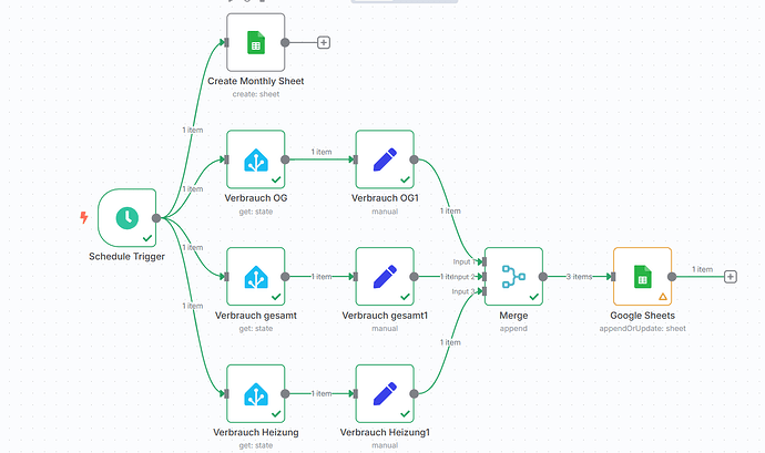

Correct way google sheet

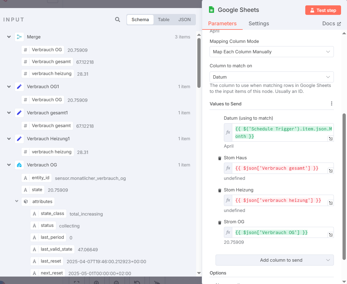

Problem in node ‘Google Sheets‘
Invalid expression
  • 1.86.1
  • docker
  • DEBIAN
    What is the correct approach for my project?
    These values ​​are read by Home Assistant and should be written daily to a Google Sheet. That is, total, first floor, and heating. Additionally, a value should be written to the sheet that looks like this: Ground floor = total-first floor-heating.
    I’ve now implemented a merge link because otherwise the same values ​​are always written, but now I can’t select the values ​​from the merge link.
Hi @daschmidt
You’re currently using the “Append” mode in Merge, which results in 3 items.
Consider switching to “Combine by position”—this will produce a single item that you can use as input in Google Sheets.
thanks this work,
is it also possible to calculate with this json data?
I tried this:
{{ $json[‘Verbrauch gesamt’] }}-{{ $json[‘Verbrauch heizung’] }}-{{ $json[‘Verbrauch og’] }}
Yes, you put them all in the same expression like this:
{{ $json["Verbrauch gesamt"] - $json["verbrauch heizung"] - $json["Verbrauch OG"] }}
