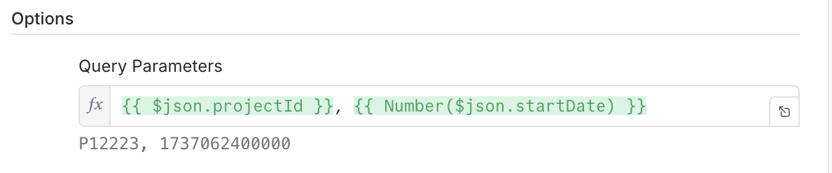

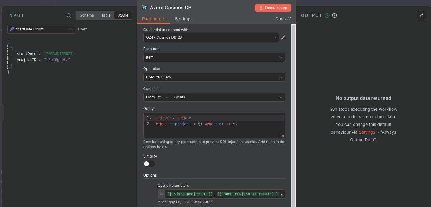

I am having an issue with the Azure Cosmos DB node (Execute Query) in n8n.
The same SQL query returns correct results in Azure Cosmos DB Data Explorer, but returns an empty result set when executed via n8n, even though the configuration appears correct.
when I use static data for second param $2 (timestamp as a Number) it works:
The query returns an empty array when executed using params via the n8n Cosmos DB node.

It seems like a bug. The issue appears when doing a substitution for a number. You should see the same issue with just startDate and no projectId. That’s what I’m seeing as well.

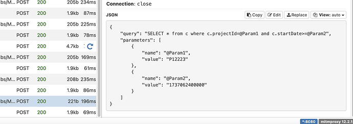

With your setup, I was able to see the payload sent to Azure cosmosdb. We can see the issue below– numbers are converted to strings:
    "query": "SELECT * from c where c.projectId=@Param1 and  c.startDate=@Param2",
    "parameters": [
            "name": "@Param1",
            "value": "P12223"
            "name": "@Param2",
            "value": "1737062400000"
The above is with $1 and $2 in use. 1737062400000 is a string which leads to no results. I have these values for the query params:

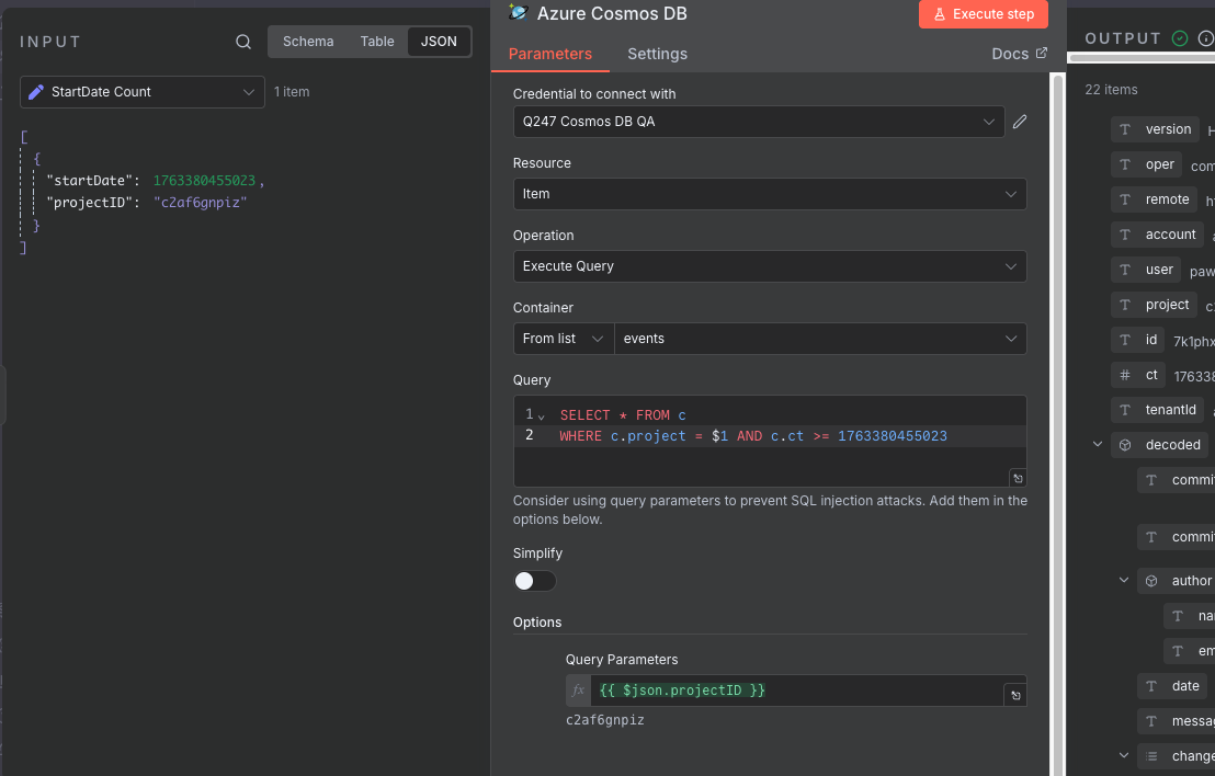

    "query": "SELECT * from c where c.projectId=@Param1 and  c.startDate>=1737062400000",
    "parameters": [
            "name": "@Param1",
            "value": "P12223"
Above is without $2 and works just fine (as you have seen). So, it reaches azure cosmosdb with 1737062400000 as a number, not string.

Those are good things to try, and, luckily, I still have my n8n+mitmproxy up . I tried them and same thing. I captured the data over wire and looks like it becomes a string before it gets sent over to Azure.
Khem
