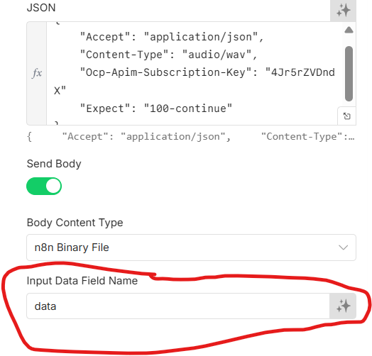

I need the voice file in binary to assess pronunciation which uses the native API of Azure speech. If I use your solution, the file information is returned. So an error will jump in.
Can you share output of the node from where you are trying to get binary data.
I use the Telegram API to download a voice file in binary format.
This component functions as a subnode within the AI Agent. As I mentioned, the AI agent primarily accepts various forms of text input, Therefore, this subnode cannot refer to binary data, so I must refer to it indirectly, and it will be written in the parameter as shown in the picture below:
So, I think that I need an expression to refer to a binary file directly.
