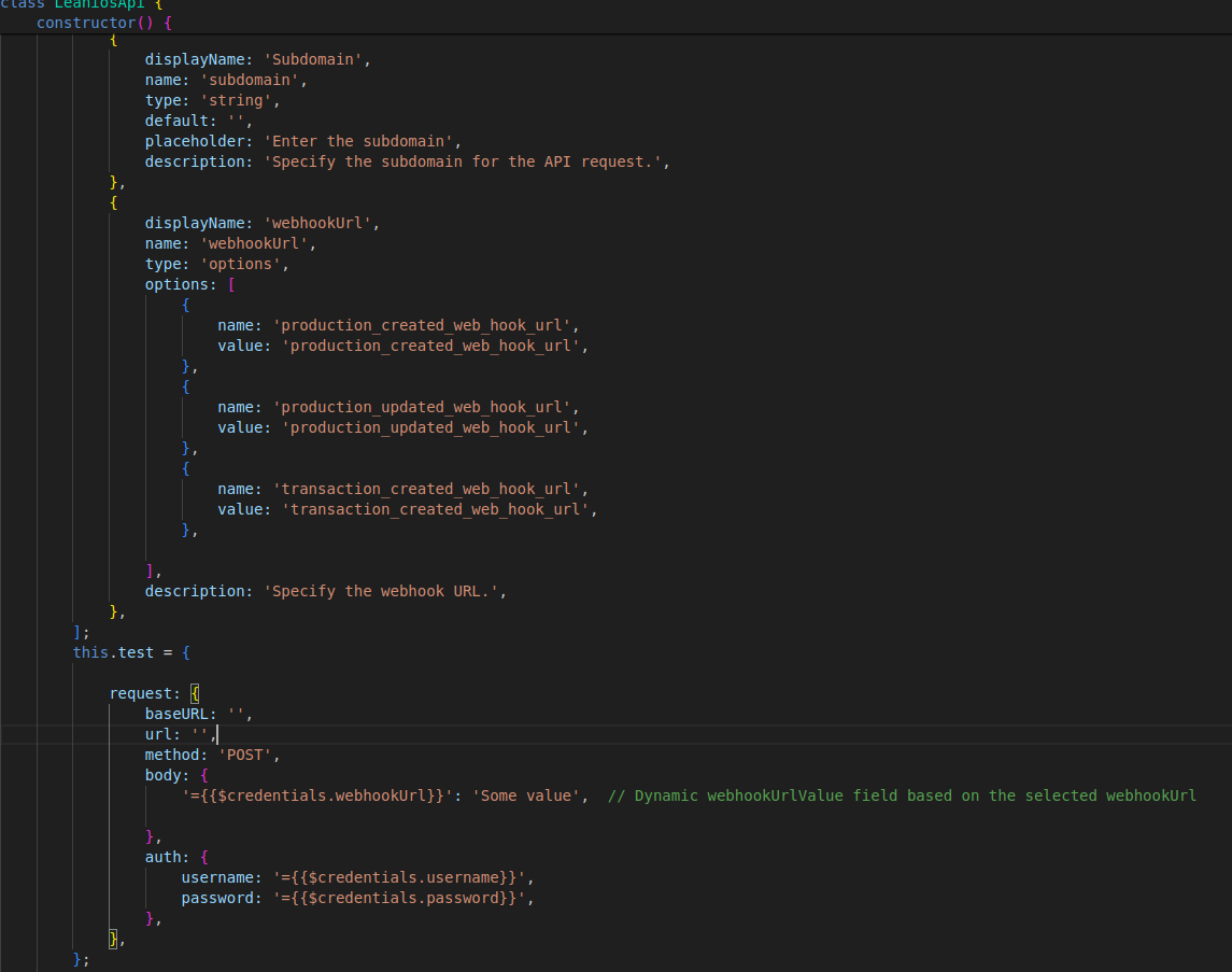

iwant to dynamically set the key in the body parameters to get the selected options in webhookUrl, instead of using a static parameter (the code provided is for custom credentials in JavaScript).
I need the test of the credentials to be triggered automatically with the POST method. Additionally, the body should include a dynamic key, using an expression instead of a static value.

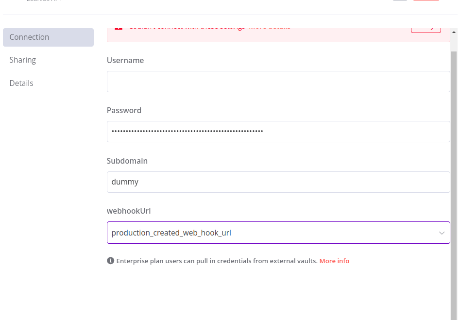

For more details, these are the credentials.
Hey @Kawther_Bensalem,
That still isn’t that clear, Where is the webhookUrl coming from is it another call you need to make to another service?
The webhookUrl field in the credentials is simply a select list for the key parameters in the body of the test request. Here is an example code:
this.test = {
    request: {
        baseURL: '={{"$credentials.subdomain}}',
        url: 'register_make_webhook',
        method: 'POST',
        body: {
            '={{$credentials.WebhookUrl}}': '={{$credentials.WebhookUrl}}',
        auth: {
            username: '={{$credentials.username}}',
            password: '={{$credentials.password}}',
