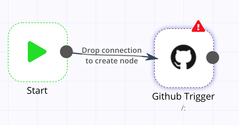

Okay, but I noticed that the webhook nodes don’t have a UI piece showing you can pass data into it, so I’m just concerned there’s something hardcoded that would require UI code.
Like the bottom one has a “socket” UI line on the left side because it can take in data.
Yeah it looks like Github implements INodeType, so it shouldn’t be a problem to add input params. I’ll look.
I was worried it would inherit from a WebHook type (or something) which would not allow inputs. Looks like your code is pretty slick :wink:
Ah no a Trigger Node will never have any Inputs!
If you want to do that, you have to add it to the regular Github-Node like posted above.
Is there a way around that? I can see some really cool systems being made if a Trigger node could be “triggered”.
I can also see this making this whole thing super complex
A Trigger-Node triggers when the event occurs which got defined for it and then starts the workflow with the data it received.
And even if we would do what you propose, it would “trigger” the workflow to start and not the webhook creation. To do something like that regular nodes exist as it is a simple REST call like all the other things which can be done with the most n8n nodes. It maybe seems like it is related to the Trigger-Node but in the end, if you think about it, it is really not.
