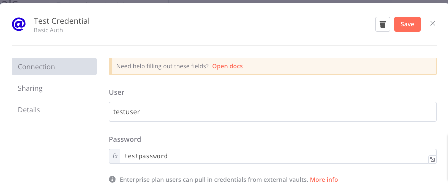

Example: I create a Basic Auth credential with testuser / testpassword and save the redential
I reopen the credential to share with users:
The password is always deleted/replace by a random key and I have to re-enter password each time I share a credential with someone (note it’s the case even if I don’t try to look/edit the pasword)

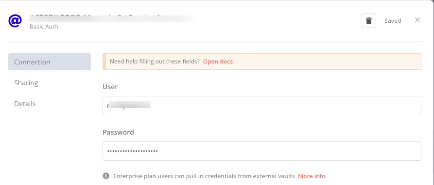

  1. I’m logged as admin. I create the credential, save it, use it in one workflow → Basic auth works well

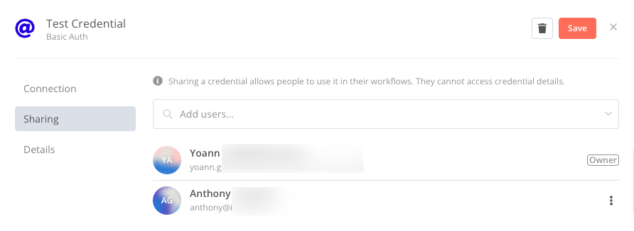

  2. I reopen the credential, go straight to “sharing” tab, add the user to share with, click on “save” and exit
  3. I re-execute my same workflow, (still being logged as admin) and got the error:
  1. I reopen the credential, fill again my password (as text), save and all works well. Each time I add someone to a credential I have to re-enter the credential password

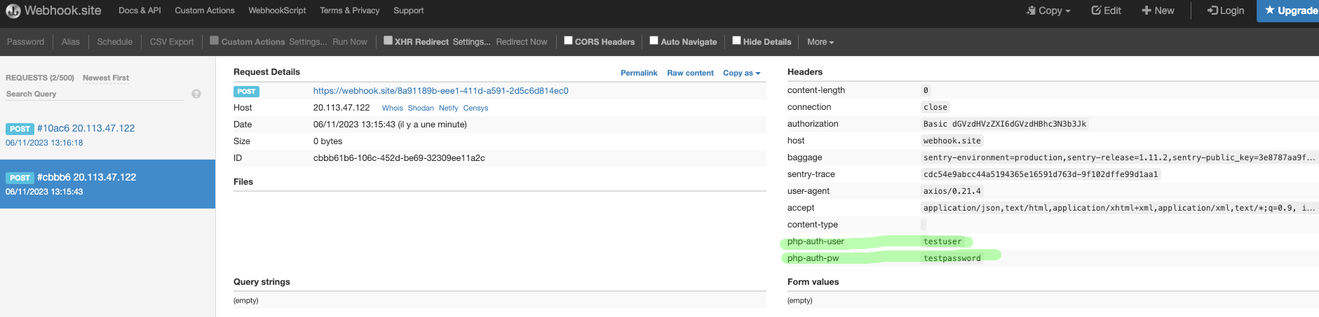

I have just followed those steps but I don’t get the same issue, I sent the credentials to webhook.site so I could check what value was there and on each occasion the correct information was being sent and it didn’t change when I shared the credentials with other users.
As a test could you create a test credential an set something like myuser and mypass then fire it off to something like webhook.site then share the credenital and make the same request and send over the headers so I can take a look? Just make sure you use dummy values as it will be public. It should look something like this…

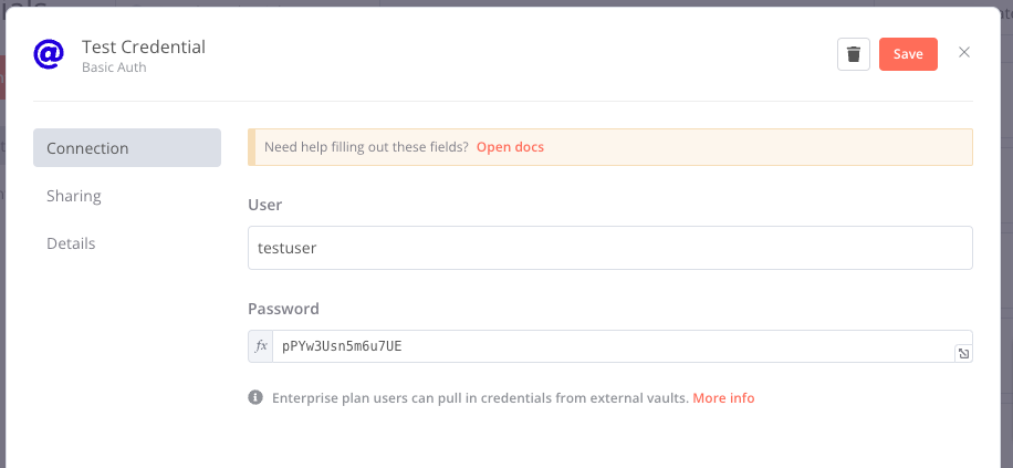

Here you are: before sharing to an user
After sharing:
Hey @Yoann,
That is very odd that doesn’t even look like a value we would change something to. Does it always set to that value?
Can you try it in private browsing mode as well? My initial thought look at that is maybe a browser extension is autofilling the field without you knowing about it.
Hey @Jon ,
You got it right, there was an odd password saved on my Chrome browser that filled this field each time. I have removed it and all works well now,
