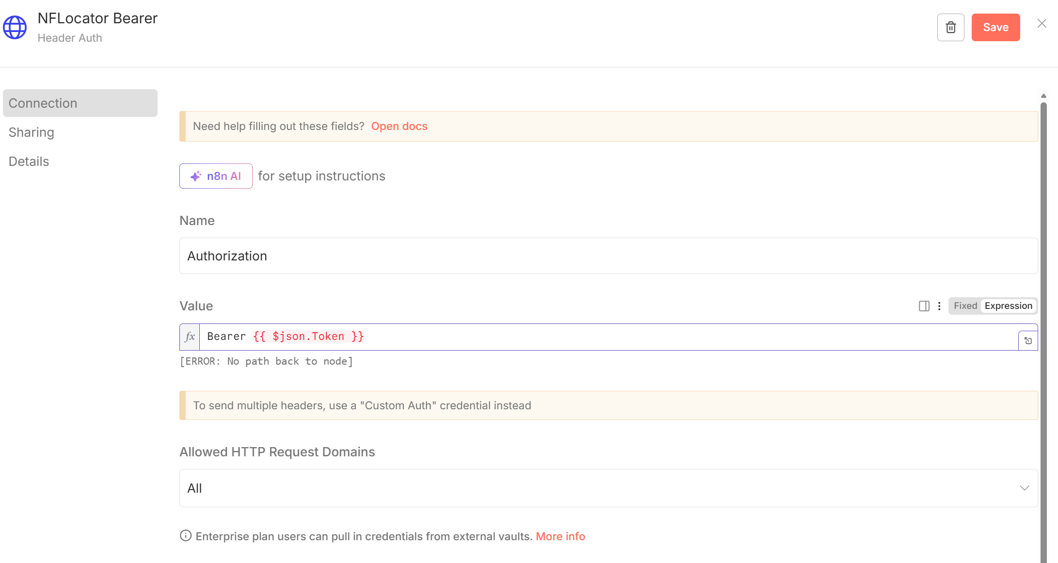

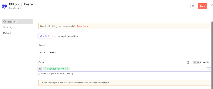

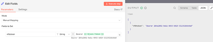

I have a set of APIs I need to call that require a Bearer token. I have several workflows that work fine using the following pattern. Call Authentication endpoint which returens a Token. Do an Edit Fields node and build a variable called btoken and set it to “Bearer {{ $json.Token }}” then add ${{ $json.btoken }} to the credential store as an expression. About 1 month ago I can no longer get the credential store to render the Bearer token. Existing workflows setup like this still work, but if I clone them or edit them, I get the error.

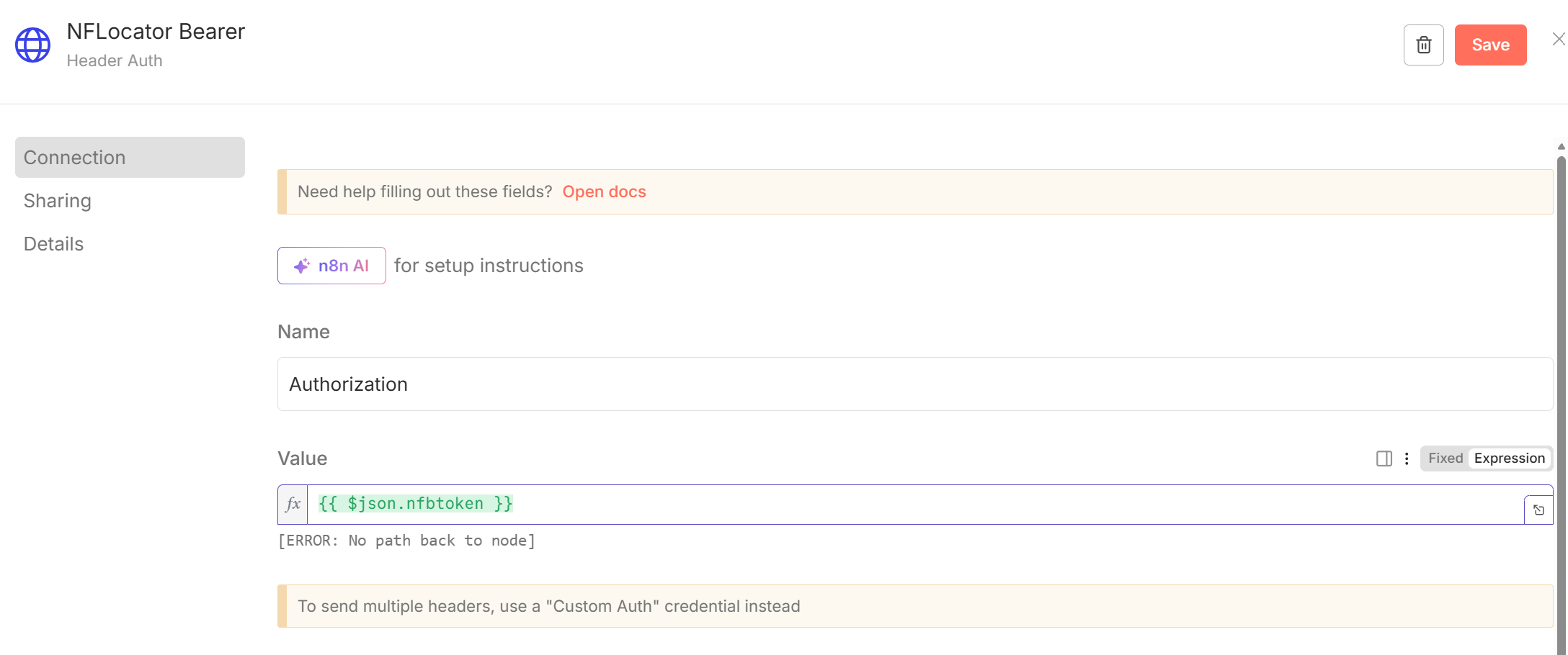

I get the message ERROR: No path back to node

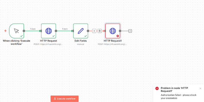

The “no path back to node” is expected while saving the credentials. This will only work when you execute the workflow.

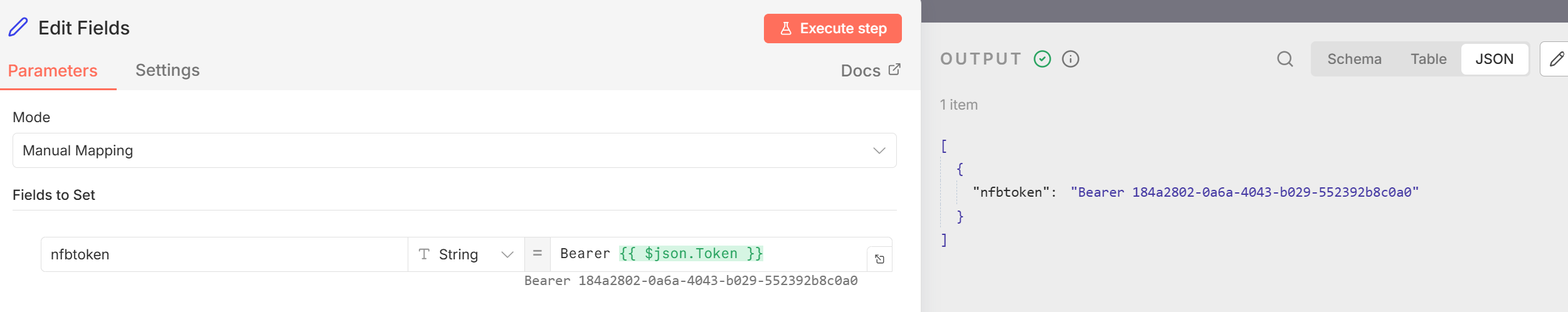

Make sure the variable is arriving at the node previous to the HTTP request and that you’re using the exact same name for the fields in the expressions.
Thank you Solomon. I had done that before and it kept failing on the last step. I went set it up cleanly again and it worked. Not sure why it was failing before. I guess the path to node thing fooled me.
