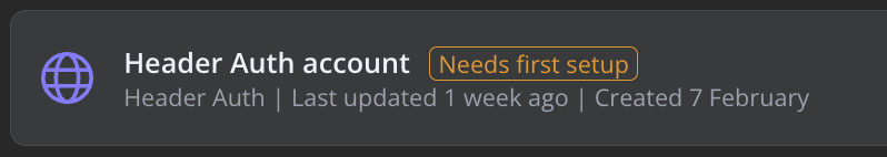

Hi guys,
We introduced a fix in 1.79.0 that now allows you to load the UI and identify the broken credentials (labelled as Needs first setup)
Do let us know if this works for you :pray:
Sadly not able to actually test this, as I had to fix it by removing credentials via the database.
