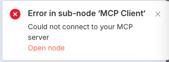

I’m automating the creation of n8n workflows via the API, I have to create workflows for each new client I onboard. I have two workflows: 1) an AI agent workflow that calls an MCP Server, 2) the MCP server itself. These communicate via header Auth.
The credential name & id match in both workflows, but the AI Agent fails to call the MCP server:
This can be fixed by removing the credential from each workflow, saving it, then adding the credential back manually in the UI. Chatting with the n8n mcp server, it told me this is because the credential is not being reloaded from the n8n database, and when I remove and re-attach the credentials this syncs the credential values with the database.
This is preventing me from scaling our business, given that this required manual intervention.

I gave this a try. creating the auth header credential used to invoke the MCP server from the other AI workflow got me closer, but still not working entirely. The auth header no longer has to be removed and re-added to the AI workflow (the one using the MCP Server as a tool), but the workflow still fails to authenticate with the MCP server. I remove and re-add the Auth Credential to the MCP Server trigger, then it works.
