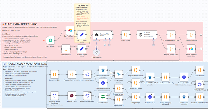

I’m not sure…. honestly brand new at this and I purchased this whole flow. It’s that bottom left node (generate video) The credentials are for replicate and it will not go.

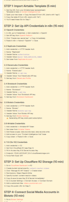

On Replicate I created the API token, plugged it into here as instructed….did all the other API’s and when I went to run it it hung up there…no mattter what I do it won’t go. Attached the full instructions as well

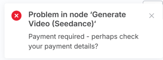

Got this now….never mentioned payment in these before lol
Well we solved your problem with authentication.
Kindly mark my answer as solution. Thanks.
Cheers!
Oh my gosh…so if I just go add $10 on replicate, I should be good to go??
yep, I think so.

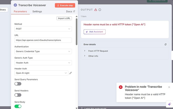

Well I got a lil further…now gives me this…double checked and all the credentials look spot on…
