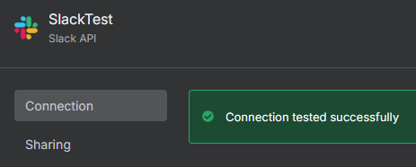

However i am experiencing issues with credential types that dont have any auth flow, for example Slack API. This operates simply by a token.
When i try to create a new Slack API credential in the UI, it just shows “Connection tested successfully”. (it does not show the Token field which is intended of course).
So everything looks good, but then it is as if this does not get finalized properly, as when i save this and try to use the credential, it lists it as “Needs first setup”.
And upon trying to use it in a slack node, it throws: Slack error response: “not_authed”

Hi @Bearman
It could be an issue with n8n not fully saving Slack token credentials when they’re created through the Embed/REST overwrite method. Even if it shows “Connection tested successfully,” it might still mark them as “Needs first setup” and cause a not_authed error. Creating the Slack credential directly via the /rest/credentials endpoint with type slackApi and your xoxb bot token, or adding it manually in the UI and saving, could fix it. If not, updating n8n to the latest version could help
