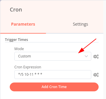

You don’t have to create multiple cron nodes to do this. Can be done easily with Custom Option
You need the below expression for this (Reference)
*/5 10-11 * * *
This will trigger the Cron node every 5 minutes between 10 - 11
I mean it’s pretty same like I did, my was */5 10,11,14 * * * I’ll try - instead of , between hours
I set */5 10-14 * * * but it didn’t trigger workflow

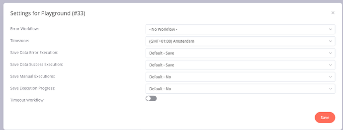

Did you set the timezone correctly on your instance or workflow?
Yes sir :grin:
I dont understand why but workflow run at 16:05, does it have to make any sense for you guys?
Looks for me like a timezone issue.
The time from the UI is in local time, the workflow runs depending on the time that is set for the workflow and the time on the server. Maybe there is something set up wrong?
So I don’t really understand but I changed now again and timezone was different (-5H) also workflow for error was empty, but I changed this after to error workflow. Anyway, now I changed and hope it will work properly, thanks!
