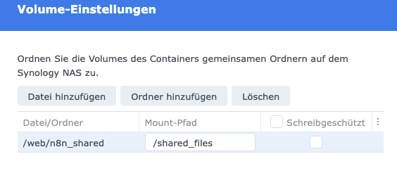

Hey Lutz, it looks like you are using n8n on a Synology-Diskstation.
make sure you add a mount for your data-folder to the respective docker-container like this:
then use your local path in n8n like: /shared_files/kundendaten_xyz

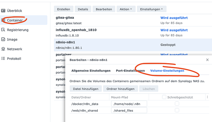

are you running n8n in Docker on a Synology DSM?
If yes:
  1. stop the container
  2. edit the container
  3. go to the tab volume-settings and add the required mounts
  4. restart your container
note: make sure you have any other volumes for n8n mapped correctly as well, my screenshot is just an example where you can find the settings and add your folder.

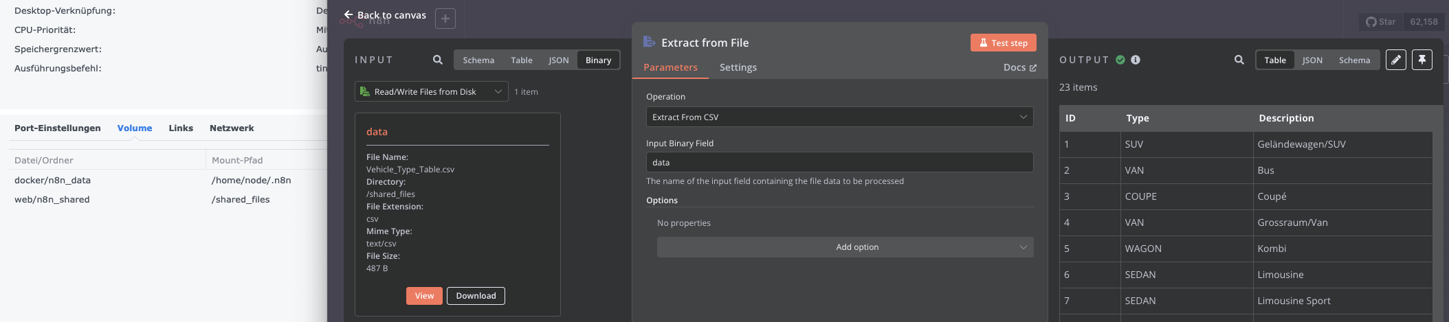

just add an “Extract from File”-node and select “Extract from CSV” and you should be good to work with your data:

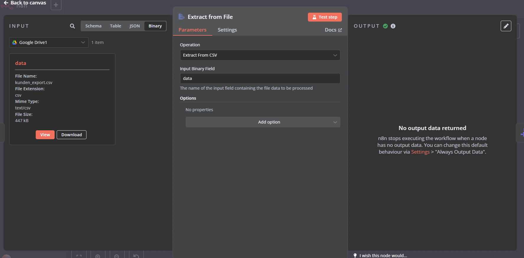

Nope. That does not work on my end.
Here is the result:
how does your CSV-data look like? maybe you need to adjust the node’s options eg specifying the delimiter and/or encoding. size of your data may also play into this, so you could limit the rows to be read.
to help you further, could you pls copy your workflow here and give an example row of your CSV-data (anonymized)?
can you confirm you run this on a Synology Diskstation and if yes, what model is it? It could also be a resource-related issue.

I just tested on a (very old) local Rackstation and it works fine to read a local csv from a mounted folder:
you may need to adjust the permissions for the docker and system-user to read from your shared folder /web/test/ like this using Synology File Station. restart your docker-container after changing the permissions.
The delimiter of the CSV = “,”
The structure looks like this:
Anrede,Vorname,Nachname,Firma,Straße und Nr.,Adresszusatz,PLZ,Ort,Telefon,Mobil,E-Mail-Adresse,Geburtsdatum,Webseite,Kunde seit,Letzter Auftrag (Datum),Kundennummer,Interner Schlüssel,Kundengruppe
filesize is about 400 kb - so nothing very big.
Hosted: Synology DS923+ / fully updated (latest n8n and latest DS from Synology)
