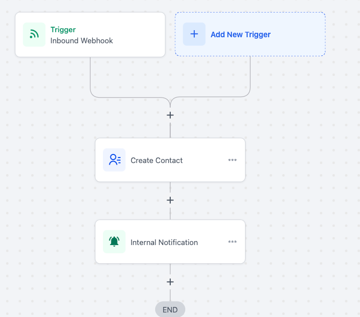

I’ve found a workaround that is working for me.
Send an HTTP to an incoming webhook in GHL with all the custom field data.
Then use Update Custom Fields in Update/Create Contact action.
Hope thisn helps.
