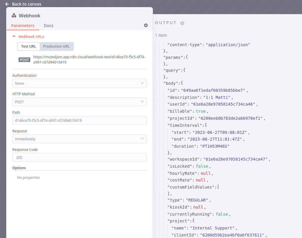

Hi @netyaco, in the meantime perhaps you want to consider using n8n’s webhook node instead of the Clockify trigger?
You can set these up in your clockify profile:
In n8n you’d then set up a webhook node listening for POST requests and would get your events with all relevant details instantly and don’t have to worry about polling:
Hi @MutedJam, this is the option that I have choosen :slight_smile:
Thanks for your recommendation!
