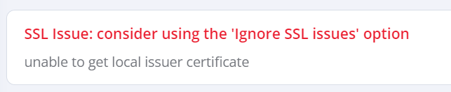

To access an API we need to provide an SSL certificate. This certificate is signed by the CA of the developer. We followed Configure n8n to use your own certificate authority | n8n Docs But we still get the following error. Is there anyone with some tips or tricks to make this work without ignoring SSL issues (then the flow works)

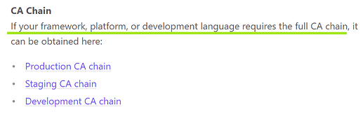

This is the CA chain documentation from the supplier: Certificate requirements and examples | Nedap Ons API
We added these CA chains to docker but it still does not work without the ignore SSL option.
To gain access to Ons API, we require requests to be signed using an SSL client certificate signed by our own Certificate Authority

Yes, we have an added the SSL certificate to the HTTP request. And the authorization works on the suppliers end, we retrieve the data, but it only works when we turn on ‘ignore SSL issues’. When we use the flow with the option turned off, n8n is unable to het the local issuer certificate.
