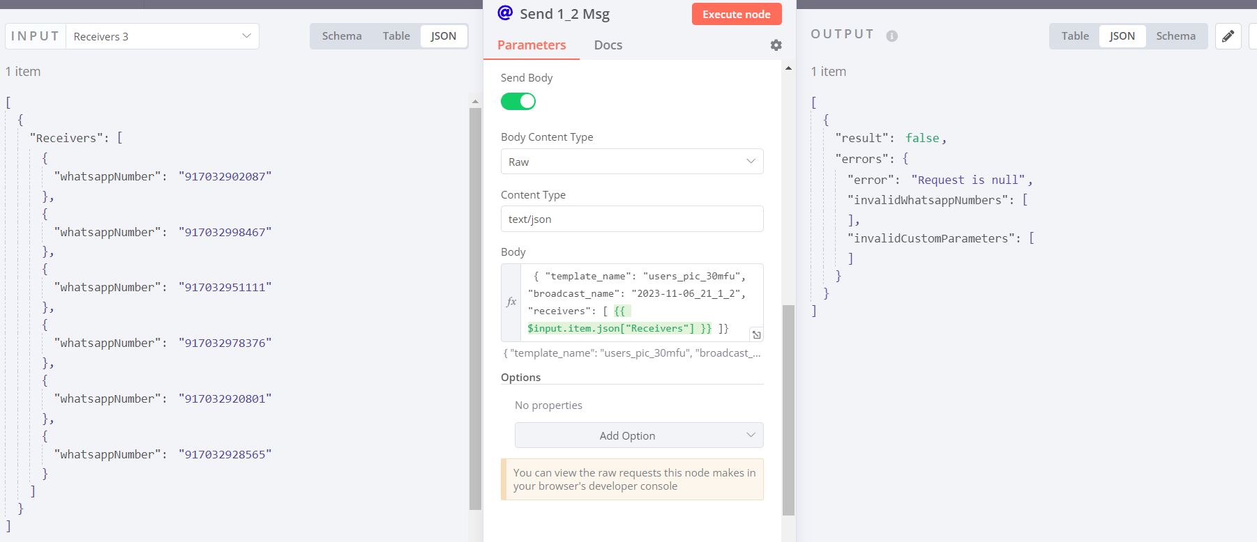

My workflow needs to pull contact list using HTTP Get request and then extract the phone no.s into an array of key value pairs to be fed into another HTTP Post request to send them a message.

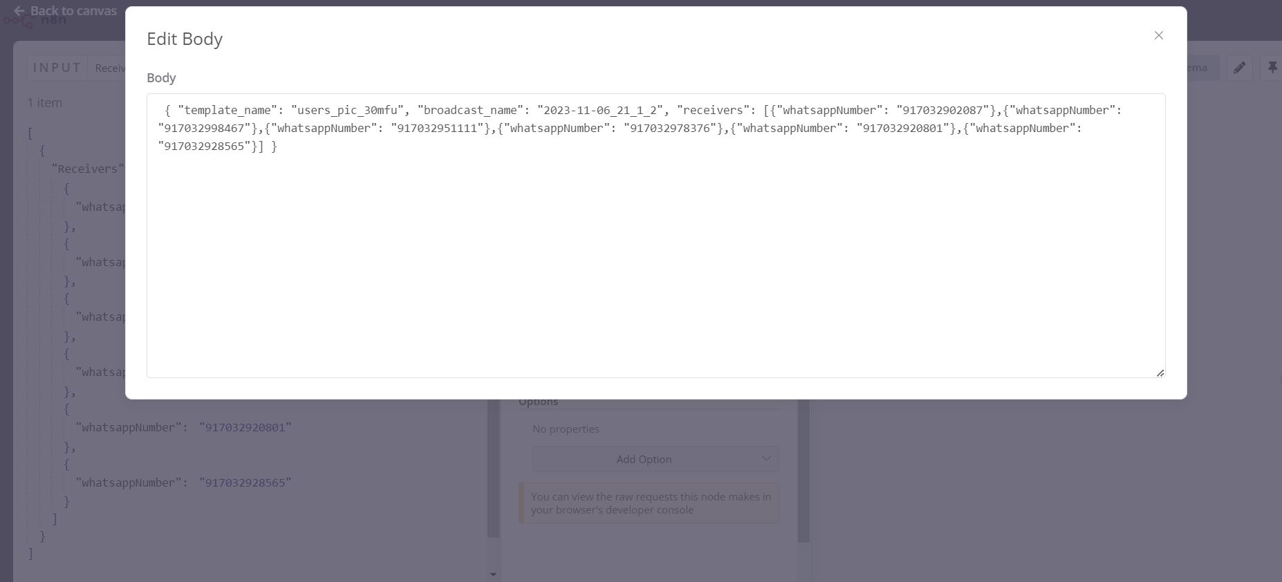

Superficially I am able to do this using Item List node and feed it into the HTTP Post node. But when the actual work flow is executed the receiving application is returning error saying “Request is null” in the Post Request.
Interestingly, if I type in the data being feed into the Post Request as a fixed type the Post request is successful but same is not working if the data is being fed as an expression from previous input.
There is no error in n8n but the application to which the Post request is being sent is returning error message that the Request is Null

"sendBody": true,
"contentType": "raw",
"rawContentType": "text/json",
"body": " { \"template_name\": \"users_pic_30mfu\", \"broadcast_name\": \"2023-11-06_21_1_2\", \"receivers\": [{{ $json[\"Receivers\"] }}] }",
"options": {}

“result”: false,
“errors”: {
“error”: “Request is null”,
“invalidWhatsappNumbers”: ,
“invalidCustomParameters”:
Share the expected output returned by the last node
