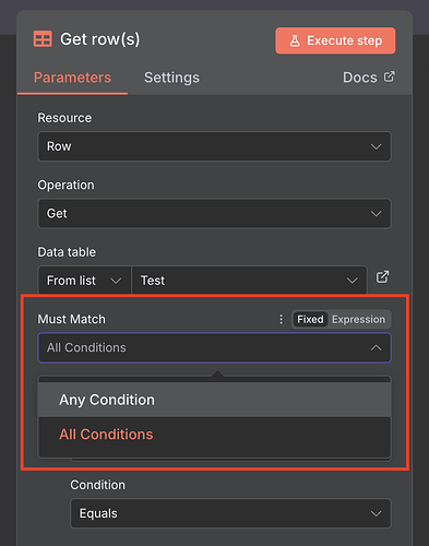

If I understand you correctly, Any Condition is like an OR and All Conditions is like AND

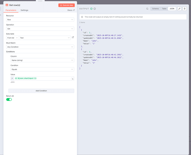

So I setup a simple table with a column named Name and colum named Value. I have put a couple of names in it, and some numbers. Then I made this simple workflow.
And then tested it. If I put mark in the chatbots I get back mark.
I don’t think I get your problem at this point (not native english) so some screenshots or something would help.
I see it doesn’t display correctly so I’ll upload a screenshot.
Hope this helps.

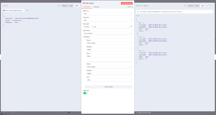

But that does work m8. If you enter the names as condition, you will get the results your looking for.

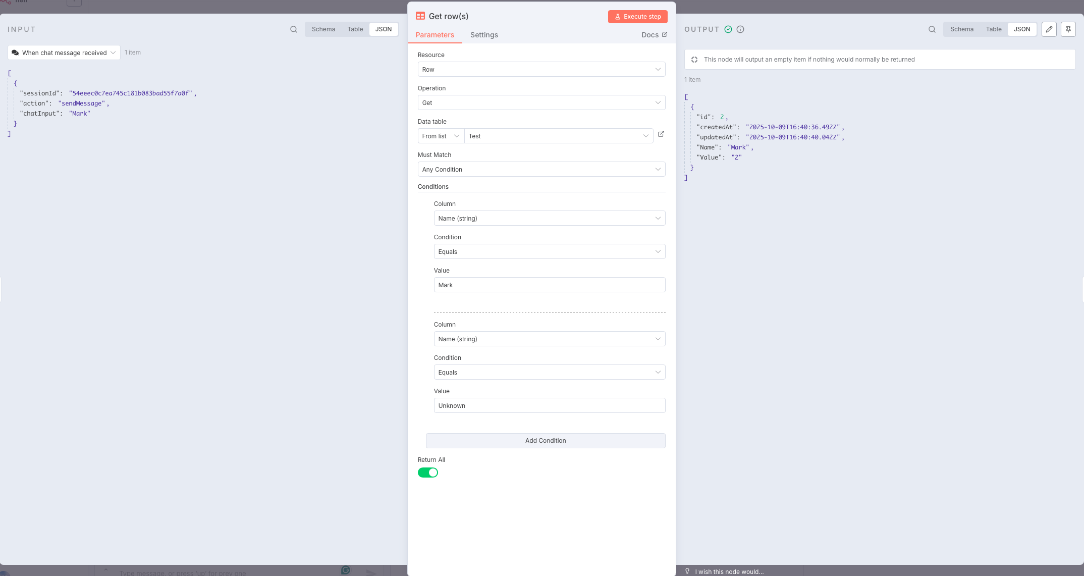

And if I change those to something else. The second value is unknown, it returns only mark

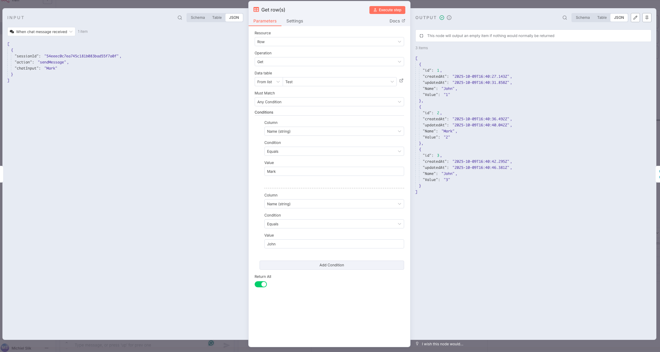

If this is the answer you are looking for. Then here you go. But I guess you want to get the values from somewhere else. A whebhook, chat or something like that.
Is this what you wanted, or do you need something else.
