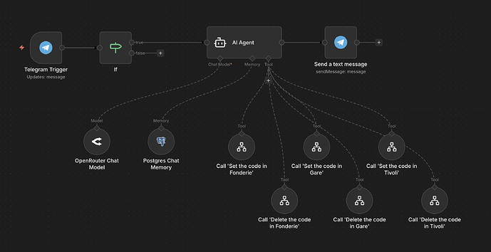

I have a workflow that allows me to set/delete door codes in our coworking spaces, with Telegram.
I’d like to add the ability to set a code, but for a specific duration. This requires setting the code, and after a few minutes / hours, deleting it of course.
What is the most elegant / secure way to do this in n8n? I’d like to keep the instant feedback when I chat with n8n through Telegram, and if possible have code deletion survive a server reboot.
How would you do this, the n8n way?

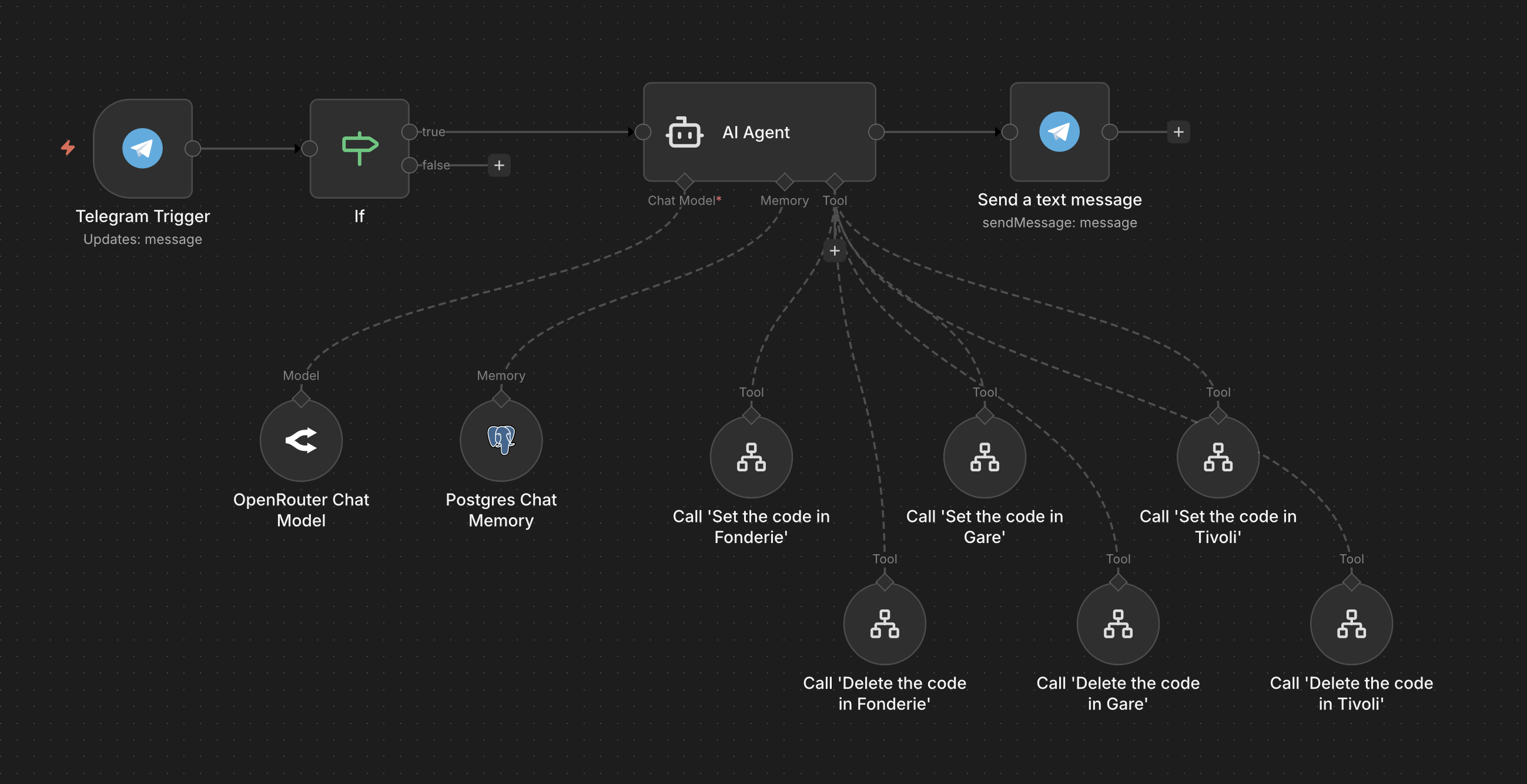

I’m using this “Scheduler” node, and my idea would be a bit different: when a node calls another one, we could specify when it is run in the future. Just like a wait, but a node that does not block at all.
In my case, from my AI node, that would allow me to run “set code” straight away, and “delete code” in the future, giving me a “temporary code”.

I struggled a bit with the text of my agent, in order to have my “temporary codes” work properly and message sent back correctly to the user. but it seems to work fine.
I’m sure it can be refined and that other AI models can be used. I have been using Claude Opus 4.5 for now…
For those interested:
You are a door assistant. Be helpful and polite when you talk with the users. You have a Telegram tool available, in order to send a text message to the user. Please use it.
The user may want you to perform these different tasks:
Task a: set the code in one of the available locations (Fonderie, Gare, Tivoli)
You can use the tools you have in order to set the code in the proper location.
After performing this task a, send a text message to the user, explaining him what has happened.
Task b: delete the code in one of the available locations (Fonderie, Gare, Tivoli), or maybe in all locations at once
You can use the tools you have in order to delete the code. Use a delay of 0.
After performing this task b, send a text message to the user, explaining him what has happened.
Task c: set the code in one of the available locations (Fonderie, Gare, Tivoli), but for a certain duration
This task requires two steps, performed in this exact specific order:
Step 1: set the code in one of the available locations, as explained in task a
Step 2: delete the code in one of the available locations, as explained in task b, but with a delay equal to the duration specified by the user
Before performing this task c, send a text message to the user, explaining him what will happen.
After performing this task c, send a text message to the user, explaining him exclusively about step 2, telling him it has already happened in the past. Don't mention step 1.
Don't use a location by default: the user has to specify it.
