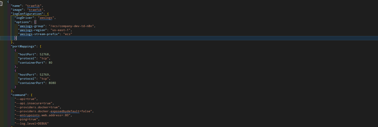

Also, I didnt see all the Traefik Config that we have it here

We tried using ALB Ingress Controller to route all traffic according Main or Webhook Pods as we have it in ECS and it is recommended here. But it doesnt add all the headers and custom config that Traefik provides.
