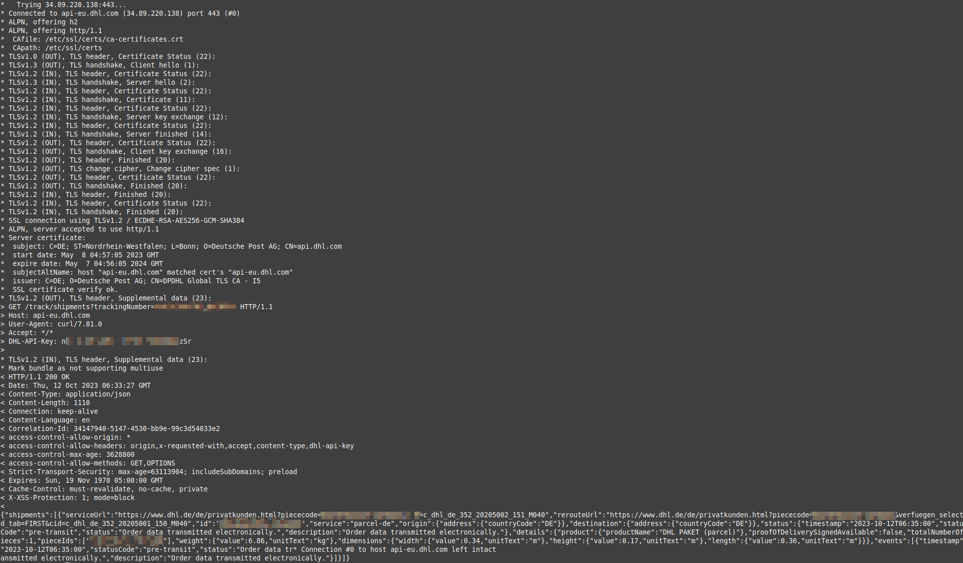

  2. Can you try sending the request through curl on your n8n server, but outside of n8n? This will help with understanding whether the connection problem is limited to n8n or affecting your entire server. The command would be curl -v -H 'DHL-API-Key: ApiKeyHere' 'https://api-eu.dhl.com/track/shipments?trackingNumber=trackingNumberHere', the response should look like this:
    curl screenshot
