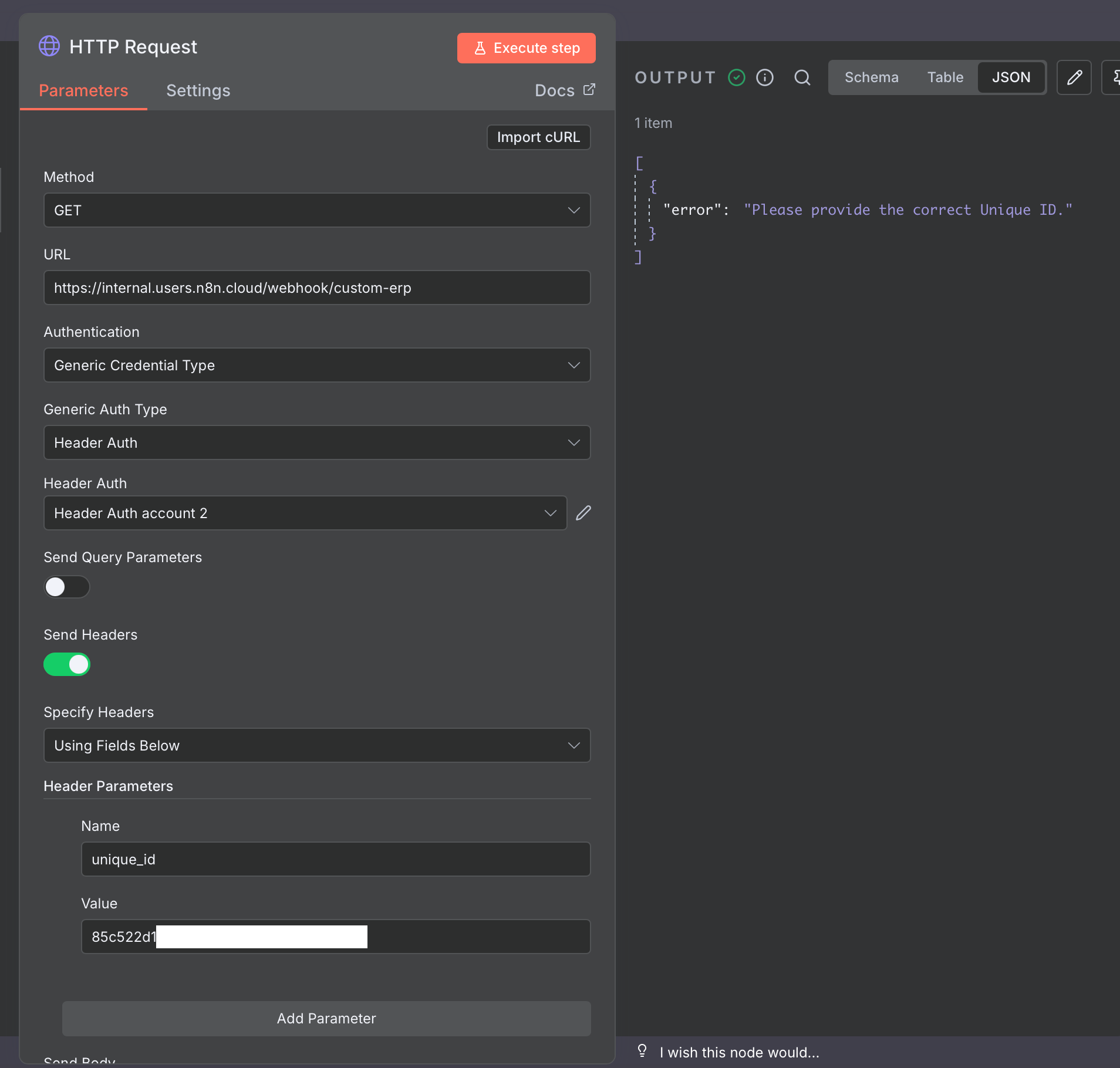

I signed up for the text courses, but for some reason signed up for level 2 instead of level 1. I didn’t notice this before I started doing the course test and I had to validate outputs.
So I signed up for level 1, and received a new email with unique ID etc. But, the ID is identical to the one for level 2. This might
I found others with the same error, but its been wrongly configured nodes, but that’s not the case here.
Had onion been able to solve this?
"error":
"Please provide the correct Unique ID."

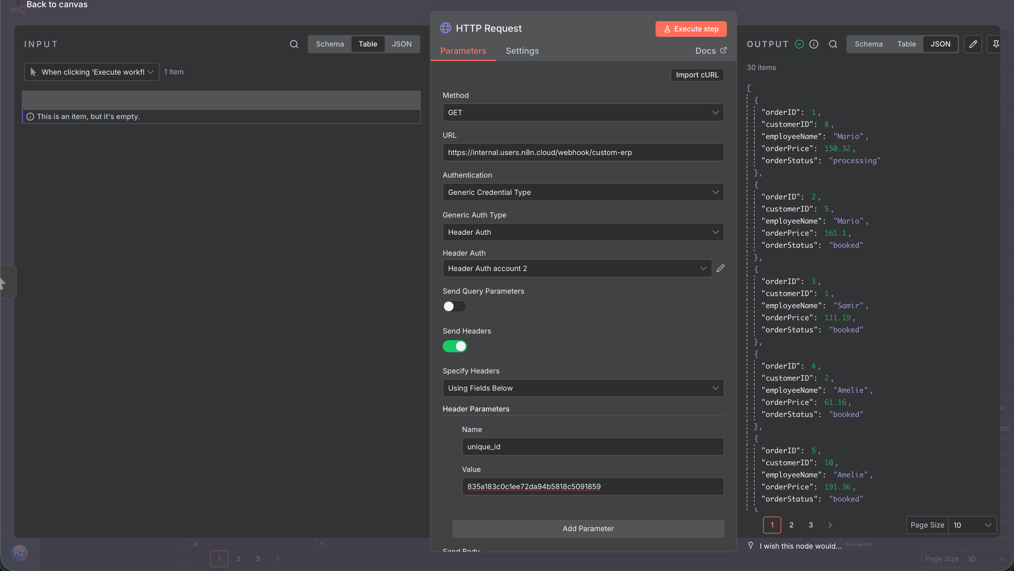

The ID is the same across courses, correct. Where exactly do you get this error from?

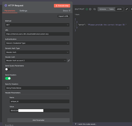

Hi, thanks for replying. I get it when I run the HTTP Request Node:
Could you test with my ID?
835a183c0c1ee72da94b5818c5091859
That works perfectly.. :slight_smile: weird?
I suspect it’s some issue specifically with your ID. Please generate a new one with a new email address - don’t worry it will allow you to submit your quiz normally at the end and you can re-submit any you already did with the old ID. Just change your email, for example, if you use gmail do:
[email protected]
Good luck and mark this as Solution if it works then :slight_smile:
