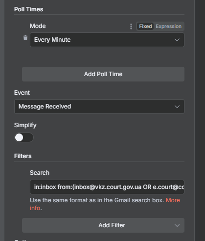

Here is settings for “Message received” node
So there are situation, when 5 messages are received in one time.
Workflow only proceeds one of them and stops.
I tried to change modes of the Code nodes to Run Once for each Item, but it didn’t change anything.
I understand, that i should use Loop Over Items node somewhere, but, honestly, I didn’t get its logic, even after watchig YouTube videos.
Appreciate your advice.
