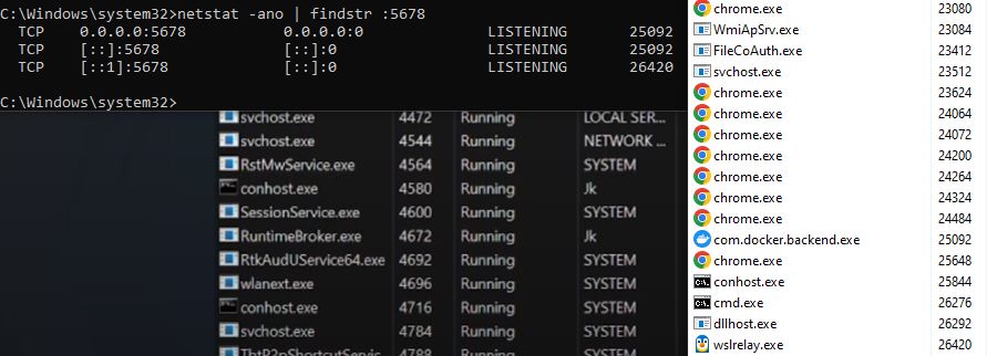

@jabbson It seems that it’s an port issue : port 5678 already allocated.
The pull gracefully stops at 32%. Com.docker.backend.exe and wslrelay.exe use port 5678.

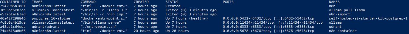

Screenie in powershell after docker ps -a
Ok it looks like you have n8n already running
unless you are looking to run two n8ns, just go to your browser and type http://localhost:5678 or http://127.0.0.1:5678 and share what happens.
Uhhh…now that you say about running two instances…
Maybe I did things wrong. After Docker Desktop install I always went to images and pulled first n8nio/n8n, Once done, I git cloned the starter kit. I see now, there’s no need to pull it from Docker first, the ai starter kit does all…omg…such a noob. Will uninstall all and do a final (hopefully) clean install.

When trying to Run the N8N image itself I get the “port is already allocated message”. So, it does not run as it already is running in the container, yes ?
Sorry for all my noobish questions, but I am completely new to this container/volume/image things…
correct, is you are getting this error, that means there is already a running container, which “occupies” this port. Which is what you can see on the second screenshot (a green dot next to the n8n).
