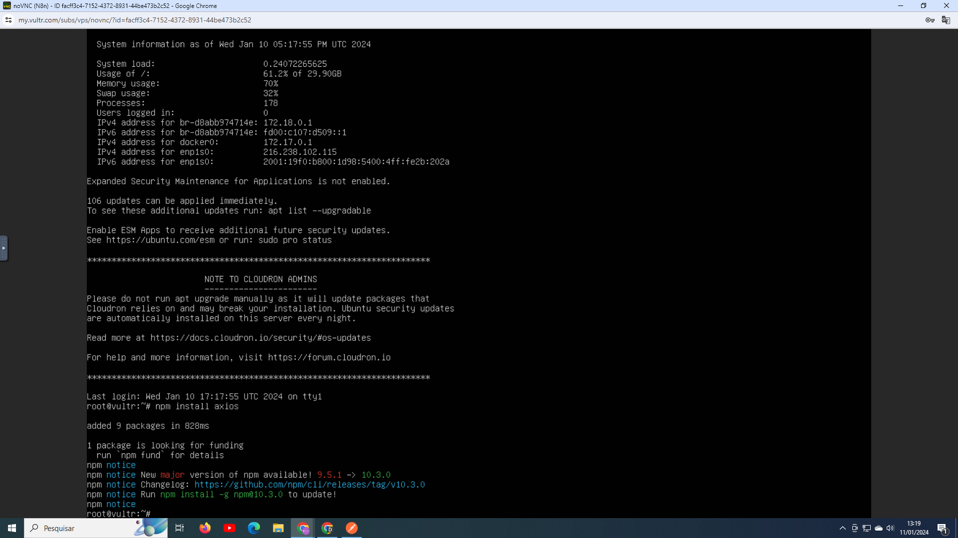

Hey @tray_corp,
Have you configured yout n8n instance to be allowed to use Axios by setting the NODE_FUNCTION_ALLOW_BUILTIN env option?
no! I don’t know how to do this, I use Vultr and Cloudrom
How do you normally set environment options in Cloudron? I am not a Cloudron user so I have no idea how that part of it works but I suspect you may have had to set the environment options for WEBHOOK_URL so it would be in the same place.

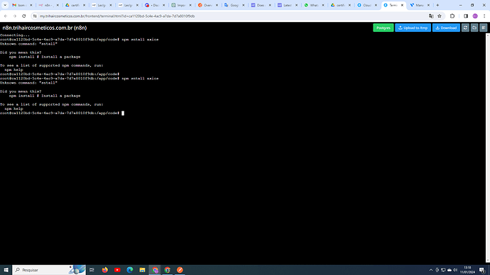

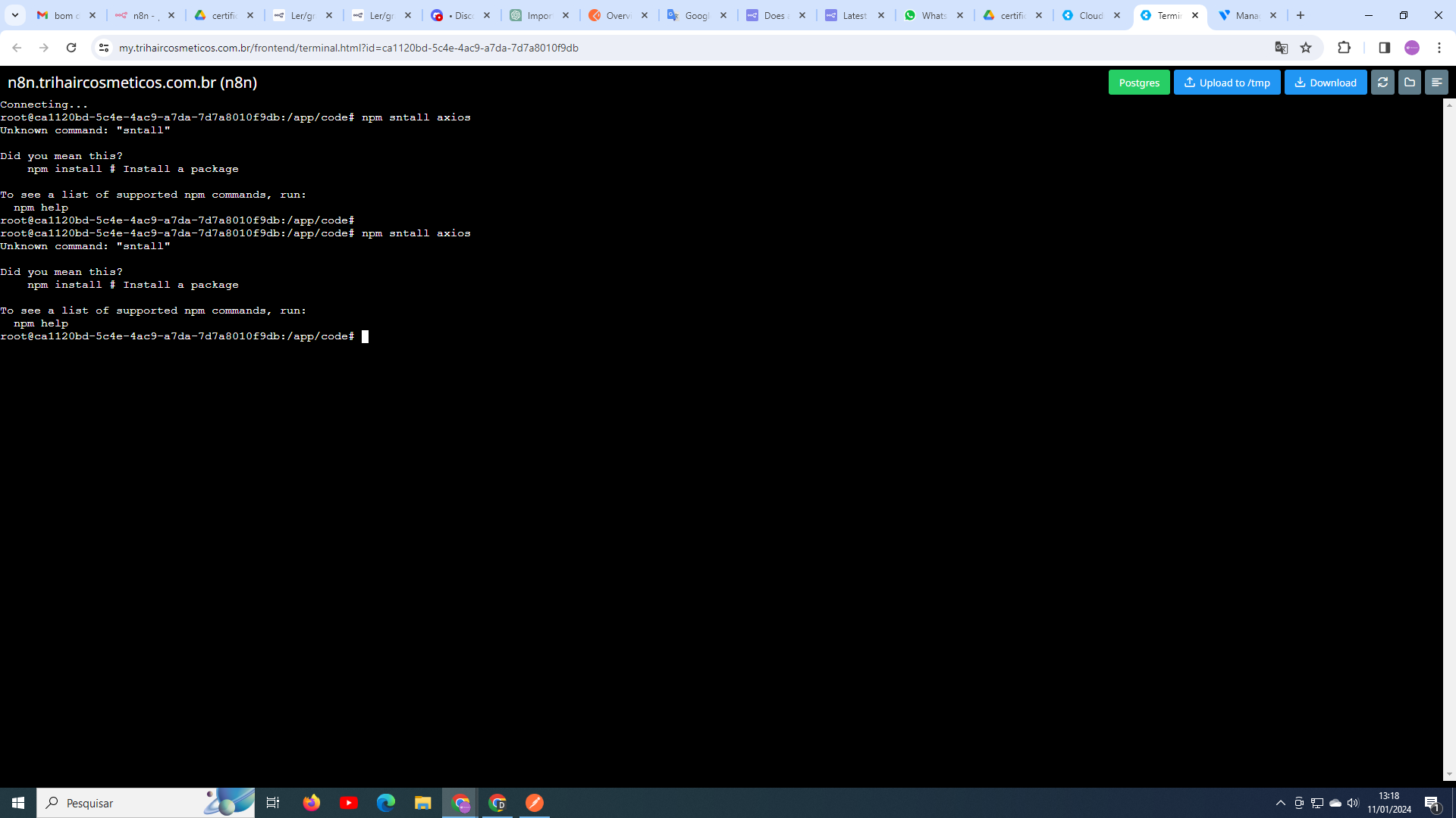

I don’t know how it works so I installed n8n
How did you install n8n? There is no need to install axios as well as we use it internally so it is just a case of setting the Environment Variable and you should be good to go.

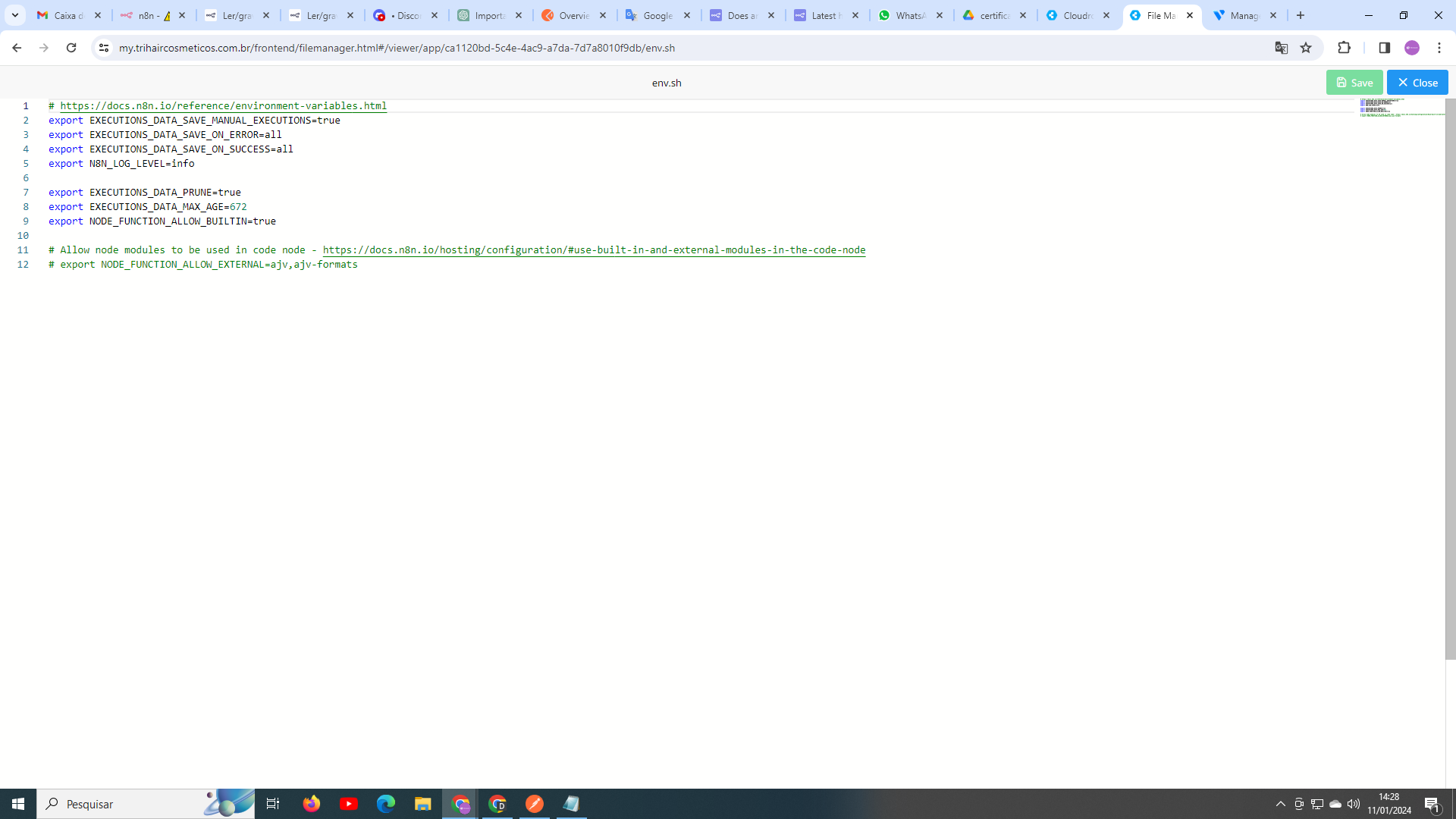

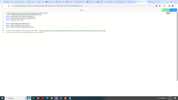

seria isso aqui
would it be this
Hey @tray_corp,
It could be but it all depends on how you have installed n8n, If you have installed n8n using Cloudron there is possibly an option in Cloudron to set this. The file you have found may do the trick but you would need to restart n8n I am also not sure if that file is read by Cloudron.
Please don’t forget that self hosting n8n is an advanced feature and we kind of expect you to know how you have set up n8n and how your chosen installation method works as there are so many platforms out there we can’t possibly know all of them.

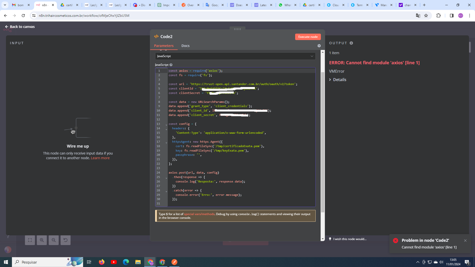

RROR: Code doesn’t return items properly
Please return an array of objects, one for each item you would like to output.
ERROR: Code doesn’t return items properly
Hey @tray_corp,
That error is saying that you need to amke sure you are returning data in the format we expect in your code. You can find some information on this here: Code | n8n Docs
I adjusted it and I am now receiving this error
“error”:
“error:0480006C:PEM routines::no start line”
Hey @tray_corp,
I suspect that is coming from back Axios, I have seen similar in the past and it tends to mean that your certificate files are not in the correct format and don’t contain the starting line which is normally something like --begin certificate---
