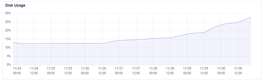

I have seen an increment in the last week of disk usage, and these are the only two new scenarios:
I have made a snapshot just to confirm; normally, my snapshots are 5-6GB. This one was 12GB…

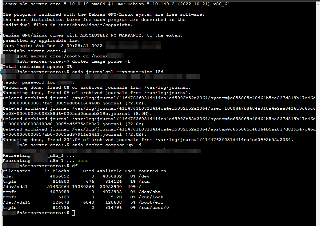

I still can’t figure out why I can’t delete the binary files… I did a manual pruning and journal vacuum:
Also, I have lowered the execution from 7 to 3 days, and now my execution went from 60k to 26k:
But I still have +50% disk used I went from 15% to 50% in one week.
Snapshot images went from 6GB to 20GB:

There are two folders: “meta” and “persistMeta”
But checking with sudo du -sh it says the folder size is 12KB so it’s not that folder…
These are the top20 biggest folders:
Any thoughts?
Hey @yukyo,
That screenshot tells us what is going on, The size is likely being taken up by the data being stored in the database. If you check your workflow settings you can set them to not log for every run and only log when events have failed. If you do need to log for everything then the server would need to be specced to deal with that.
It would also be worth setting the vacuum option which may help to free up some of the space once the execution data is deleted.
