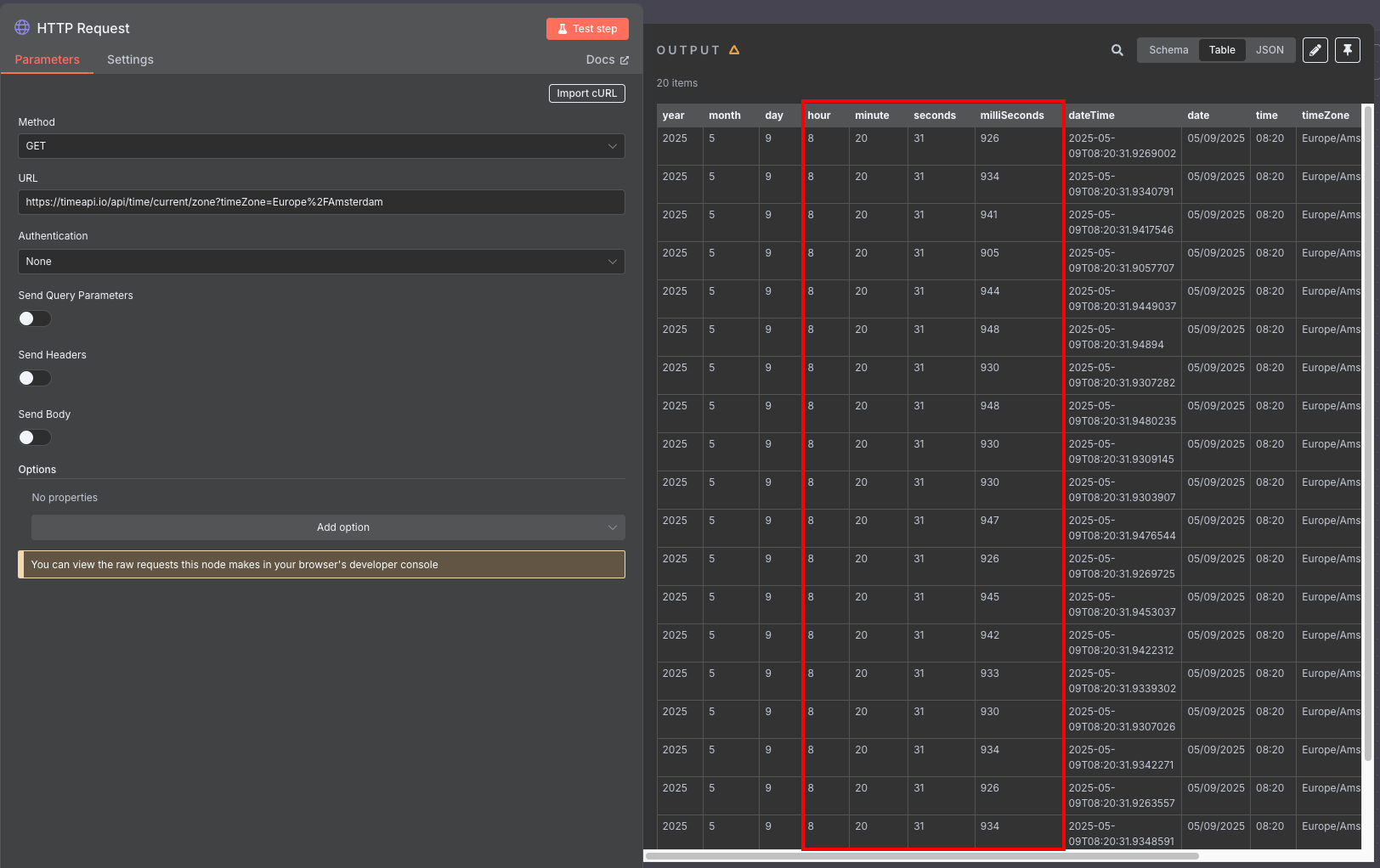

For the above example, there are currently two items as input to the HTTP node. I want to know whether both those API calls will be made sequentially i.e. one after another or both the API calls will be fired in parallel and the response to those API’s will then be give as output.
Normally, these run at the same time.
It also depends on how n8n is set up, such as if it’s in Queue Mode with a limited number of workers.
Also, the HTTP Node lets you set up batching.
Without batching all requests are done within a few ms.
With batching only 5 requests are done in parallel. Then the interval is waited.
