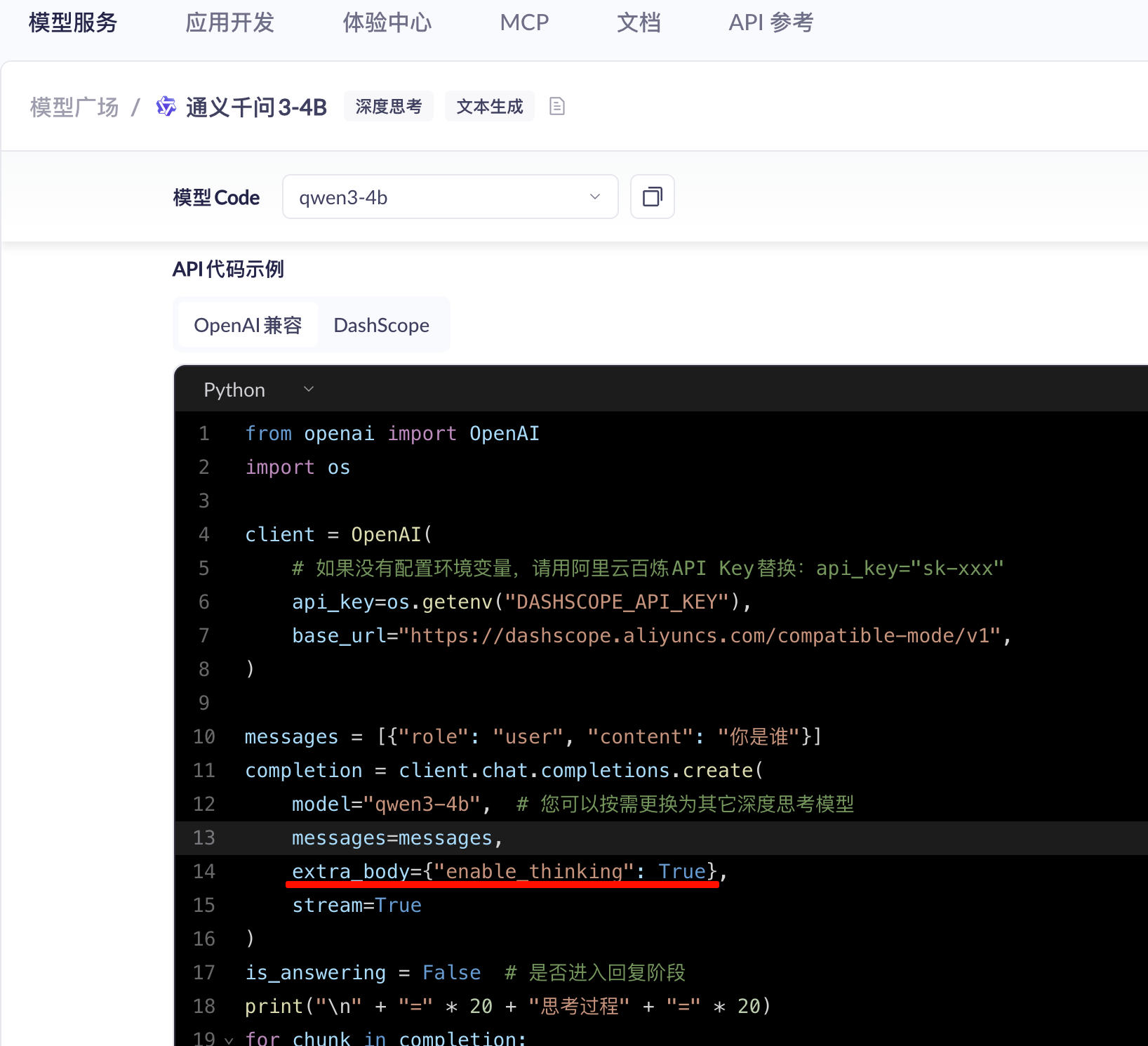

I use OpenAI Chat Model node, I want to use qwen3-4b llm, it has an option :
extra_body={“enable_thinking”: True}
how can I add this ‘extra_body‘ option ?

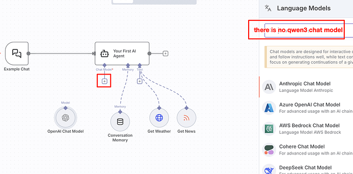

but “HTTP Request node“ can’t connect “AI Agent“.
if “AI Agent“ can connect “HTTP Request nod“ , it’ll be very good

I have only qwen3 api and api key, it’s an OpenAI-compatible API,
but there is no qwen3 chat model,

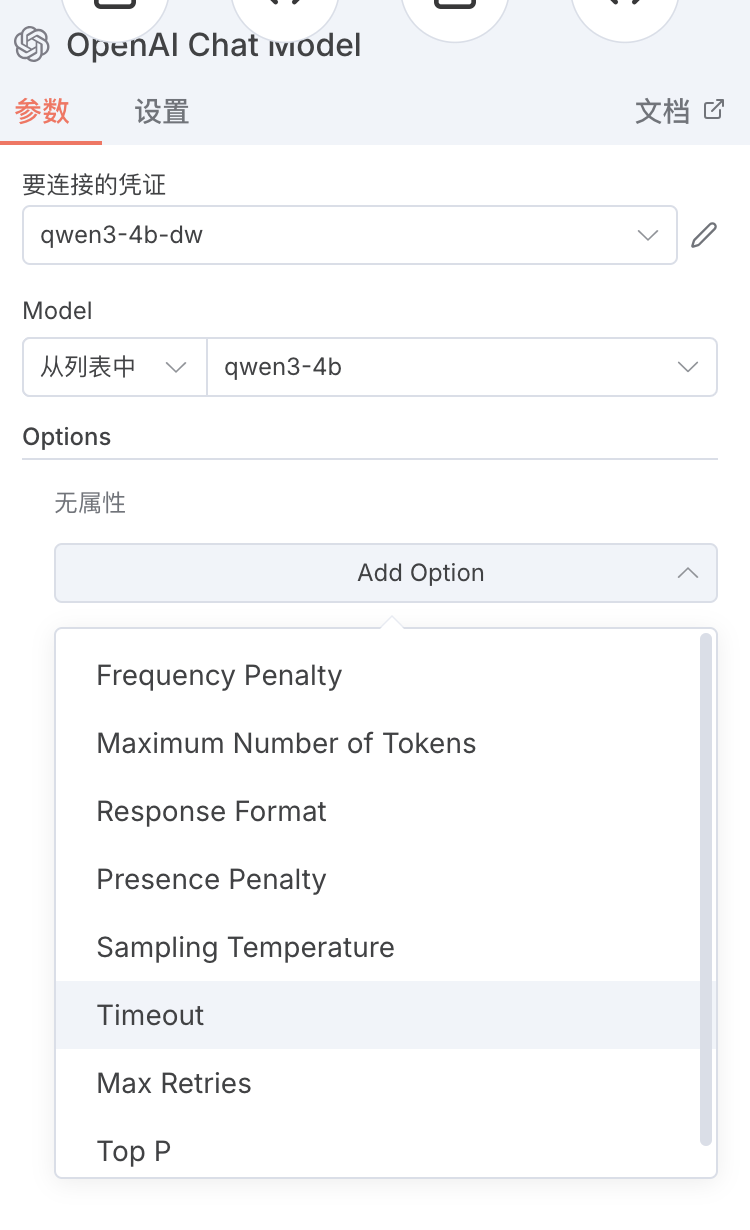

I can only use “OpenAI Chat Model“ node,
but I want add an option extra_body={“enable_thinking”: True}
how should I do ?
Unfortunately, there’s no option to add this directly..
Hopefully in the future there will be an additional option to include custom configurations..
However, if you’re familiar with LangChain, you can add a LangChain Code node and replicate the AI Agent node inputs/outputs and include enable_thinking but this approach requires coding and some LangChain knowledge and it’s not very flexible in the end..
