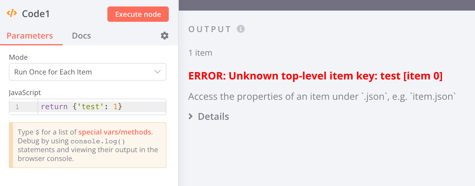

Hi. Can someone please explain to me why I can’t create an object in the code node and return it when it’s set to “run once for each item”?
Error:
ERROR: Unknown top-level item key: test [item 0]
Access the properties of an item under `.json`, e.g. `item.json`
I need to build a fairly complex object for each item and return that… I don’t understand why that’s possible in one mode and not the other. Any insight appreciated.

Currently, the Run once for each item mode expects you to output the data in the format:
return { json : <your data> }
Ah nice. Thank you
